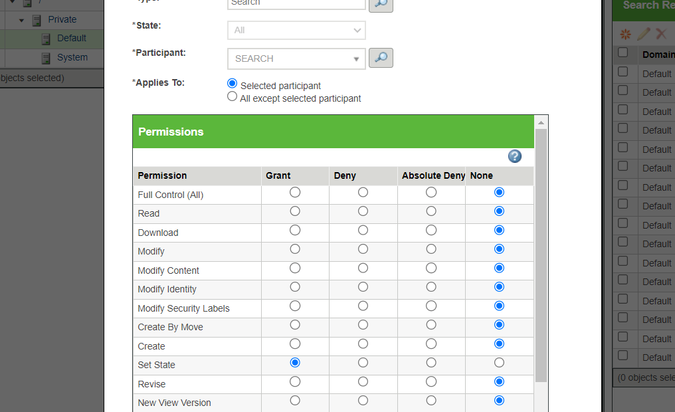

This would in each context utilities page - Policy Administrator.  Create a new right in default context. For the objects you want to give access, there should be a set state right that you can grant. You can give it based on all states or certain states. Click the starry icon to create a new ACL rule. https://support.ptc.com/help/wnc/r12.0.2.0/en/#page/Windchill_Help_Center%2FPolicyAdminACLManage.html

It is under Site-Utilites-Policy Administration.
You need to drill down to the proper context and object type and then edit it for the current state from the table.

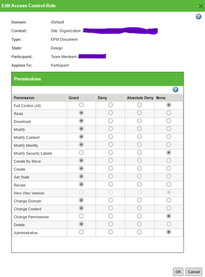

Are you utilizing Promotion Requests to set file states? If so, you should let the workflow handle the Set State changes and only grant the system admins the ability to Set State. It does depend on which direction you are changing the state to/from.
I allow all users to change the state from Design (initial state for all objects) to Pre-Release. This can only be done IF the file version is at a numeric number. We use alpha version for prototype work and numeric for production releases. The user does a revise, then overrides the next alpha version for the numeric version. They have to do the Set State to Pre-Production at that point. The promotion request workflow is set so only certain states can be selected depending on the current state. Design state gets promoted to Prototype and Pre-Production goes to Release or Verification Required.
