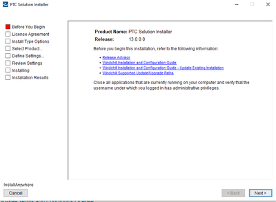

just like in the title I am trying to install test server on VM and I am not able to launch PSI wizard for Windchill 13.0 and 12.1. When I run setup.vbs there is progress bar with some configuring info and then window is closed.
I have java:
java version "17.0.8" 2023-07-18 LTS
Java(TM) SE Runtime Environment (build 17.0.8+9-LTS-211)
Java HotSpot(TM) 64-Bit Server VM (build 17.0.8+9-LTS-211, mixed mode, sharing)
 and java in environments:
Thanks in advance.

Have you seen this notification on the PTC homepage?
It leads to this article: https://www.ptc.com/en/support/article/CS398580
Try rolling back to an earlier build of Java.

Yes, I tried to launch it also thru powershell with administrative priviliges but same issue. It's closing after the startup progress bar will hit 100%.
Same errors occurs on Windchill 12.1 PSI.

thank you, it works!
