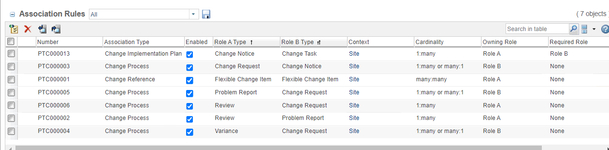

Hi @DKWc
What Windchill version do you use?
Windchill 12+ has a Change link business rules . Check the rules if the system is correctly configured or not.
Also check if the rules are not disabled
PetrH
Hey Hi,
Thanks for the reply.
Good point this area completely slipped.
Checked for it nothing is disabled.
