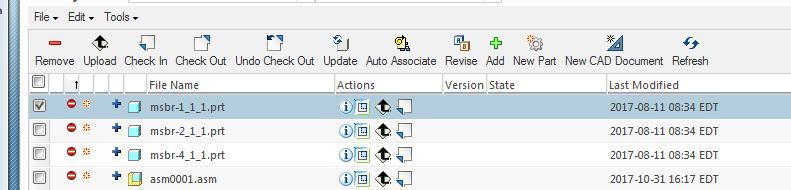

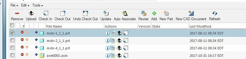

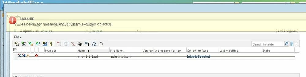

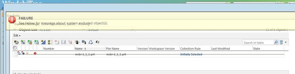

Trying to checkin and assembly but I have serveral parts that show up as "new local" and name conflict.  I've tried doing an update on these parts wiithout but get more errors.  Below is are screen shots.
November 13, 2017
Do those numbers exist in WIndchill already? If so, rename them in the workspace and then check them in with unique names.
