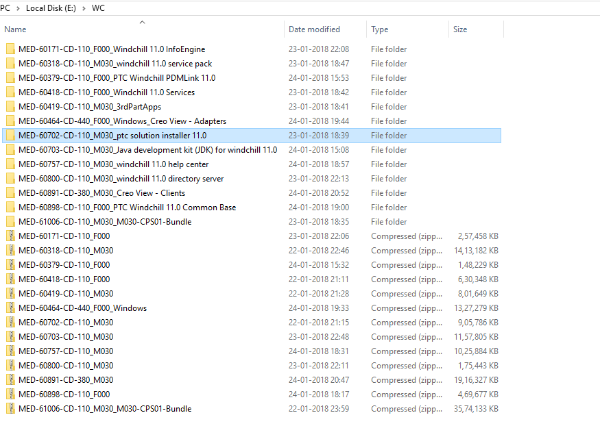

  • Please don't rename your folder source like that "MED-60703-CD-110_M030_Java development kit (JDK) for windchill 11.0" , my own but PTC hate that ( extra space, special character etc.. )

Have renamed just to make things easy and avoid confusion- i have kept the extracted and zipped files in the same place. Have a look: 2018-01-29 19_03_46-WC.png

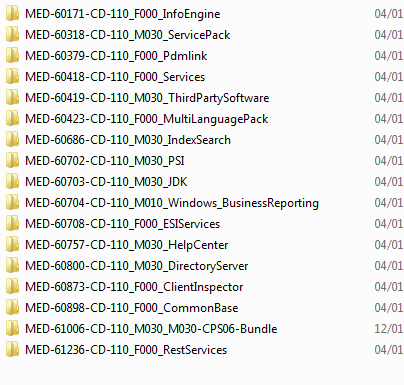

FYI i manage my sources like this:Capture.PNG
