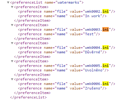

Hi @Amirtharaj_K
btw, your preference xml file does not contain configuration for ini files.
this is the reason why it does not work for you

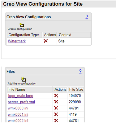

Hi @Amirtharaj_K
Yes it is possible, you need to set visualization configuration to force users to use the Windchill configuration
CS35006 - How to configure the use of watermarks in Creo View, based on CAD Document lifecycle states in Windchill PDMLink
Create server-side watermarks in Windchill PDMLink server:
  1. Browse to Creo View preferences location in Windows Explorer; default path is %APPDATA%\PTC\ProductView
  2. Rename file user_prefs.xml to server_prefs.xml
  3. Launch the Windchill Visualization Configuration Administration utility from the target Windchill Context Utilities
  4. Create a WVS Configuration and upload the server_prefs.xmlwmk000#.ini and Stamp related *.bmp files to it (can also be done using a Zip file containing the same files

Hi Mr. Petr
Image 5: I added the ini in the windchill server creo view and set it as default to enable printing and viewing. We can see that watermark in below. (Renamed the user_prefs.xml to server_prefs.xml)
Image 6: Added in Creo View Configuration
Image 7: I opened with another machine who have the URL link access if that user tried to open in his machine through Creo view he couldn't see the watermark. (In that machine I am not adding the ini)
And i din't know where I can set "true", please give me more explain.

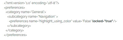

@Amirtharaj_K
The article describes it how to set locked preferences
I guess that you miss some configuration in the watermark creation where you need to set a type of document where the watermark has to be shown,.
The ini files should be used from windchill instead of use the local one.

Hi @Amirtharaj_K
example
PetrH
Please check this one, I tested it's not working.
Hi @Amirtharaj_K
Please, can you just set your creo view instance that can show the watermarks as you need
and use the user_prefs.xml as a server_prefs.xml with full definition ?
it should work.
PS: I use true/false without capital first char. It can be case sensitive.
PetrH
It works Thank you for your support Mr. Petr, please share more details to create preference.xml for other things.
