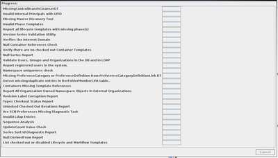

I am using Windchill PDMLink Release 11.0 and Datecode with CPS M030-CPS11
WinDU Freezes.
Tried suggested tech on PTC document, didn't work
Any suggestions?

Which document? Are you getting an out of memory issue or a very long running test? Which one's were executing when it froze?

ChiragBarot
(To:avillanueva)
This is what I see
I started well over an hour ago.
Did you get prompted for authentication already? If not, the authentication window could be in the background.
No it did not prompt me for authentication.
I checked, nothing waiting in the background.
If you did not get prompted for authentication and did not provide authentication in the command line, its likely stuck there.
Try authenticating prior to running windu
windchill --javaargs="-Dcom.ptc.net.auth.user=wcadmin -Dcom.ptc.net.auth.password=<password>" wt.auth.Authentication
tried this too....no luck
