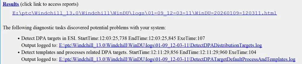

WinDU found potential problems but not clear what the problem is
  • January 9, 2026
  • 2 replies
  • 68 views

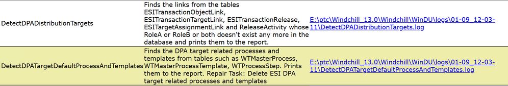

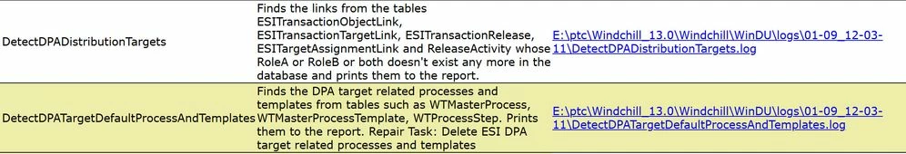

Any suggestions what the potential problems could be?
What's a DPA target?
I ran the repair tasks for both issues but it found nothing to fix and problem is still there.
Fri 1/9/26 12:03:25: Starting analysis of Distribution Targets
Fri 1/9/26 12:03:25: From 12.0 onwards, Publication support for Distribution Process target has been removed. This utility diagnoses ESI
Fri 1/9/26 12:03:25: * Distributed Process type target to clean up existing DP targets . This utility finds and prints these type of targets.
Fri 1/9/26 12:03:25: Following are the ESI Distribution Target of sub-type Distribution Process.
Fri 1/9/26 12:03:25: ================================================================================================================================================
Fri 1/9/26 12:03:25: Time taken to execute: 2ms
Fri 1/9/26 12:03:25: Found 0 Distribution process type targets.Use ESIDPATargetLinksRepairTask repair task.
Fri 1/9/26 12:03:25: Analysis of the ESI targets completed successfully.
Fri 1/9/26 12:11:29: Following are the templates and processes related to Distributed Process Target.Use ESIDPATargetDefaultProcessAndTemplatesRepairTask repair task.
Fri 1/9/26 12:11:29: ================================================================================================================================================
Fri 1/9/26 12:11:29: Object Object Info
Fri 1/9/26 12:11:29: Found 0 corrupted records in the tables WTMasterProcess, WTMasterProcessTemplate, WTProcessStep.
Fri 1/9/26 12:11:29: Time taken to execute: 0ms
Fri 1/9/26 12:11:29: Found 0 objects related to DPA target.
Fri 1/9/26 12:11:29: Analysis of the tables WTMasterProcess, WTMasterProcessTemplate, WTProcessStep completed successfully.
Best answer by avillanueva
Confused, it found 0 cases. I think you can ignore this. I get the same results on my runs.

Have you opened a case with tech support?
rhart16-PearlAuthor
January 9, 2026
I have not
jbailey
18-Opal
January 9, 2026
I would open a case with tech support, at least in parallel to this.
avillanueva
23-Emerald I
23-Emerald I
January 9, 2026
