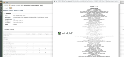

Could anyone confirm if the Windchill 12 base license can create and manage WTpart? I am being told only Windchill advanced license can create WTpart since it has EBOM management feature.
My understanding was that Wtpart creation is part of the core PDM functionality included in base licenses. We were planning to use base license for all design engineers to auto associate Wtpart during check-in process. and use advanced license for the BOM planning team and Managers.
Kindly confirm as per your experience.
Thank you
Best answer by Fadel
Nope , it doesn't allow it at least on 12.1 :

Base license does allow for creating WTParts via auto-associate. So a design engineer would need Base license AND the Creo Data Management license, assuming you are using Creo.
That will allow the design engineer to check in a file with auto-associate selected, and the WTPart will get created.
To create WTParts directly (not auto-associate) or to edit a WTPart, you would need more than just the Base and Creo Data Management.
avillanueva
23-Emerald I
23-Emerald I
November 20, 2023
Correct but for full features, you'll need Windchill Advanced license:
There will always be cases where you will need to edit or create Parts. Cannot assume that all can be done via auto-associate.
