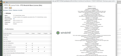

Nope , it doesn't allow it at least on 12.1 :

Base license does allow for creating WTParts via auto-associate. So a design engineer would need Base license AND the Creo Data Management license, assuming you are using Creo.
That will allow the design engineer to check in a file with auto-associate selected, and the WTPart will get created.
To create WTParts directly (not auto-associate) or to edit a WTPart, you would need more than just the Base and Creo Data Management.
Correct but for full features, you'll need Windchill Advanced license:
There will always be cases where you will need to edit or create Parts. Cannot assume that all can be done via auto-associate.
