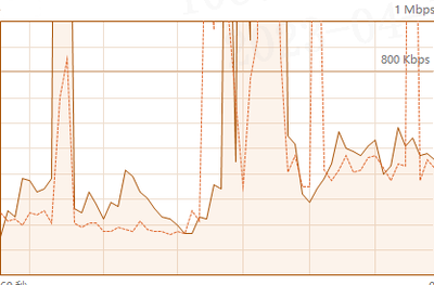

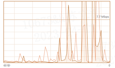

When I use croe, work with windchill use the local workpace,
Almost every action need to wait seconds:
like opend workspace : 14 seconds
open a part to a new window from a assembly : around 5 seconds
replace a part in assembly model :15 secods (after i click the confirm button).
I check the  task manager, looked creo use the network for very step.
Would anyone know the reason?
Am I use wrong configuration ? how can I optimize it?
Thanks in advance!

this is nomal situation :

Are you working on a VPN? Have you tried eliminating that to see if it a source of the extra traffic you aren't expecting?
You might want to check out these creo config options:
dm_cache_limit 0
dm_save_as_attachment no
dm_synchronize_in_background yes
dm_network_threads 6
