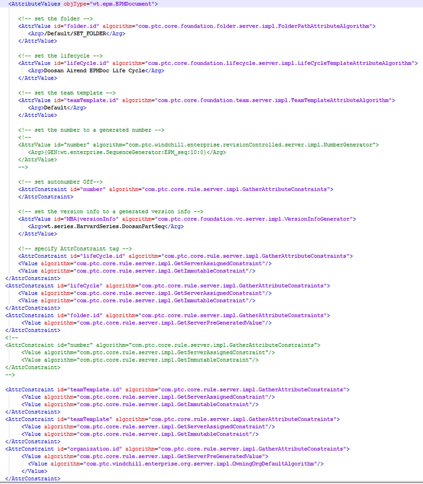

Looking for how to prevent users checking in new EPMDocuments into Windchill default folder.   We have a default folder set in the OIR, if the users do not change the folder before check in, then the EPMDocuments will check in to that default folder.  I am looking for a way to prevent users checking into that default folder.  I want it to fail check in and force them to select another folder.
Can this be done? seems like I have seen this on windchill 10.1, not sure about windchill 11.  See our OIR for EPMDocuments below.
