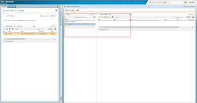

However, the change request file is not visible

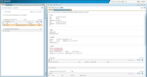

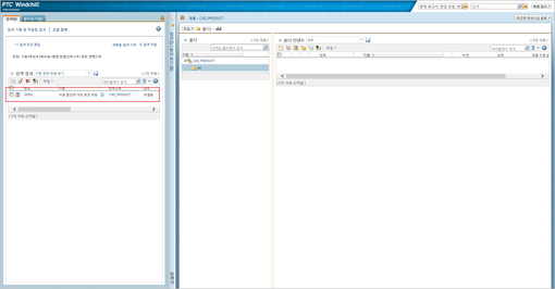

Through the search, there is a change request file like the picture.
If you view the information in the file and click on the location
Nothing...
Is Windchill not seeing the change request file?
If not, why not see the change request file?

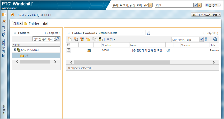

Don't you have a filter ?
if i set a All in filter then Object not shown..
but if set a Change Object in filter then object show
why is the object not displayed even if it is set to All?
