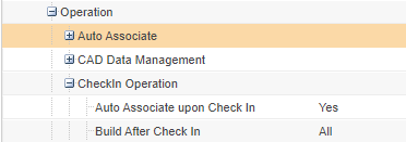

The Mech Engineer has been creating the 'gear' part manually. I think this should be automatic when the CAD is checked in, as part of 'bottom-up' design: the 'gear' should appear. Yes, I know there is a default to make this automatic, but for me it does not make any difference whether I have to click the check box: the 'gear' does not get created when the CAD is checked in. And we get the above error which does not tell me what I need to know.

It can be created automatically. You need to set this preference at site level:
Just know that when you allow this, all garbage models will have gear parts created. Queue Facts of Life song.
