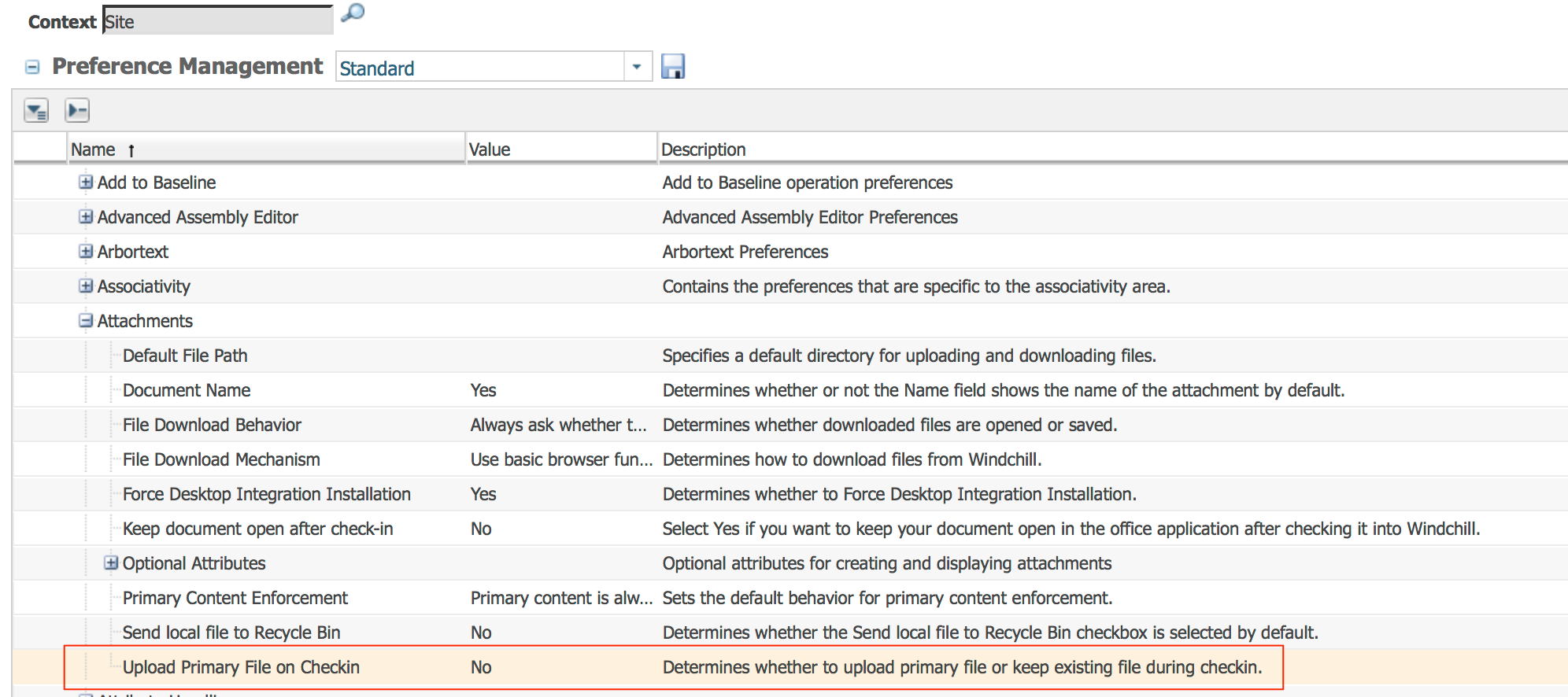

In Windchill 10.2, Edit multiple objects can mass edit an attribute, but however, for WTdocument, you have to click the radio box "do not upload file" for each item you select. This is unacceptable when editing 1000+ documents. Any ideas?
(I'm clear that it is easy to write customized code to mass edit an attribute, but I'm finding a way every user could easily access.)
Thanks!
Best answer by BineshKumar1
You can set the below preference.
Under attachments, upload primary file on check in. Wouldn't fit for all the use cases, as the users would miss upload primary content during regular check-in.

Thank you, this solved my problem.
