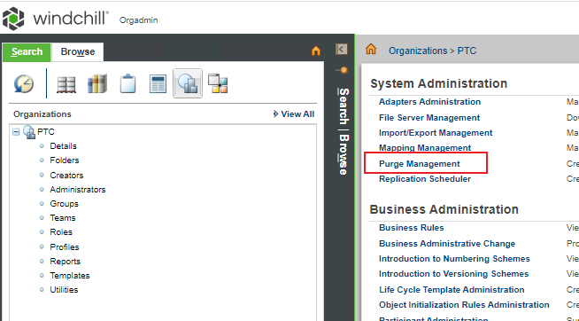

Hi @HH_10580701
Please use Purge Manager
  • Purge Management is used for deleting earlier (non-latest) iterations of objects i.e. Documents, Parts or EPM/CAD documents
  • All or All But latest versions can be purged. All versions are included by default
  • Purge Management can be accessed by navigating to Site or Organization > Utilities > Purge Management
  • Only the Org admin and the Site admin can access Purge Management
https://www.ptc.com/en/support/article/CS20325
