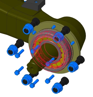

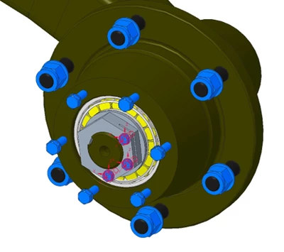

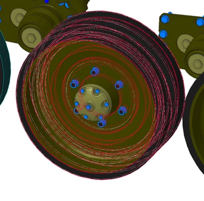

The pictures from my example assembly below are from Creo parametric, where it is easy to hide parts to select parts behind. And this state is also only temporarily.
First level of part selection:
Second level of part selection:
Third level of part selection:
The model consists of many hundreds parts and it not really practicable or possible to find them in the model tree in te Vuforia Editor.
So the function to temporarily hide parts is essential to efficiently create procedures.
