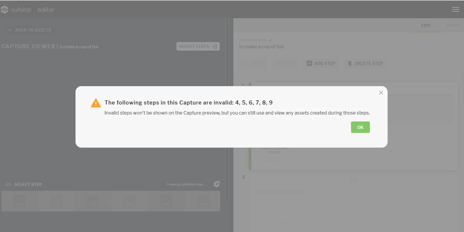

I recorded a procedure for making tea to familiarise myself with Vuforia Expert Capture with a Realwear device HMT-1.
I recorded 9 steps.  When I tried to add the new procedure in the Vuforia Editor I got the following error message that I also attached. That some of my steps were invalid and would not be seen.
Why did this happen? I followed the procedure and proceeded to each new step by stating "Next Step" and it started recording each new step.
Please help?

I tried uploading the file again so that I can see if there is anything else that shows up as an error in the browser.  However no if I upload the folder I don't get any error message or invalid step error.
It appears as if it might have been some glitch which has either since been resolved or something else. At least i found that I could edit the videos separately and just upload them. This is not ideal but at least I could still make the video.

We have seen this error when the expert hasn't formally "finished" the capture by saying "finish capture" when they are complete.
In our case, the expert didn't turn off the HMT-1, so we were able to easily go back into the capture, say "finish capture", and re-upload the capture folder into Vuforia Editor. That resolved our issue with the invalid steps message.

I am sure I finished the capture and I also edited the title before saving the capture.  I suspect something else must have gone wrong.
At least I had all the videos so I could manually add them to the procedure.  I had to edit them in another editor though to be able to cut the videos as required.

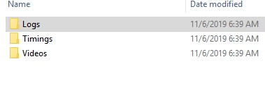

Is there a way that I can check if the "Finished Capture" maybe didn't work or what else went wrong? Any log files I can access?

There is a log file in the folder containing the raw video clips you save to your computer from the HMT-1. These may be able to tell you where something went wrong. I've attached a screenshot of one of our examples showing the log folder.
I hope this helps!
