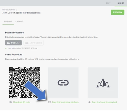

When publishing a procedure, a new option is available called “Copy link for desktop playback.”  This option provides a URL that can be accessed by any desktop, laptop, or 2-in-1 laptop that converts to a tablet and supports Windows and MacOS versions of Google Chrome.  This link will always reflect the most up-to-date version of the published procedure.  You can also embed this link in PDF files, work orders, or any system that allows you to manage, schedule or provide information to your manufacturing operators and service workers.

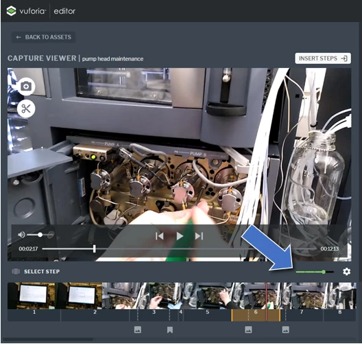

Video timeline zooming
When procedures have many steps, the timeline may become so crowded that it is difficult to navigate and effectively select video segments for clipping.  A new timeline zoom feature allows you to magnify the timeline so you can comfortably navigate and make clipping selections.
