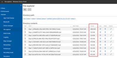

Videos are not recorded correctly on my HoloLens 2. Only very small mp4 files with a size between 40 and 120 kilobytes are stored. I use the latest Windows version on the HoloLens 2 (19041.1106.arm64fre.vb_release_svc_sydney_rel_prod.200605-1330
a.k.a. Windows Holographic, version 2004 - June 2020 Update ) and version 11.11.212.0 of Vuforia Capture.
On the HoloLens 1 I can record videos without problems.
[Capture files (zip) are attached.]

Thank you. R&D and support have communicated that to me already. They also found out that upgrading to the latest insider build of Windows solves this issue.

Yes. This is reproducable. Today was Microsoft patch day. Just updated to the latest Windows OS release on the HoloLens 2. Latest version is now 19041.1109.arm64fre.vb_release_svc_sydney_rel_prod.200709-1217
The problem is still reproducable.

Apologies on the delay. We are actively working with Microsoft on a fix for this. Reverting back to Hololens build 18362 should resolve the issue. Instructions on how to do so can be found here: https://docs.microsoft.com/en-us/hololens/hololens-recovery#clean-reflash-the-device
