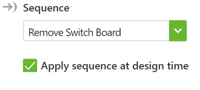

Hi, dear community!
Can I skip the sequence step from a list for example - step 3 was made accidentally in a sequence list and I do not want to change it in Creo Illustrate because I use one 3D sequence file with 10 figures-animations + I use 10 views (with Wayfinder waypoints on each view). If I change the sequence file in my Vuforia Studio I would need to correct or reconnect all my Waypoints for all 10 Views.- and I don't want to do it.
Please advise how I can skip the sequence step or how I can set up Wayfinder so it does not lose waypoints after reuploading(after the update) the 3D sequence file.

Hi, @ClayHelberg Thank you so much for your response!
I assume I am doing something wrong, because my step 3 (I want to skip) is still there, please advise.
This is my JS:
$scope.next=function(){
  if ($scope.getWidgetProp("model-1", "sequence").includes("Remove Switch Board")) {
if ($scope.getWidgetProp("model-1", "currentStep")==2) {
$scope.setWidgetProp("model-1", "currentStep", 4);
$scope.step=$scope.step+1;
  $scope.view.wdg["model-1"].currentStep=$scope.step

It's hard to try to debug code just by eyeballing it, but one thing that does jump out at me is this:
 // the part below overwrites the skip above
The second part of this, where you increment $scope.step and then use it to set the model currentStep property, basically overwrites the bit above where you skip the step you want to skip.
One way to fix this would be to reverse the order of those code snippets, like this:
