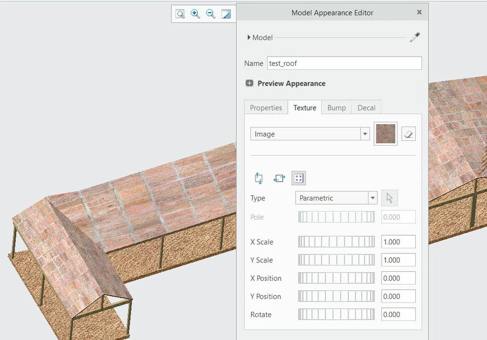

So this is the most used way to use textures in Vuforia Studio.  Also UV setting are something what should be set in the CAD tool - e.g. in Creo Parametric:

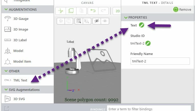

The GLSL code should be added in the text area of the tmlText widget:

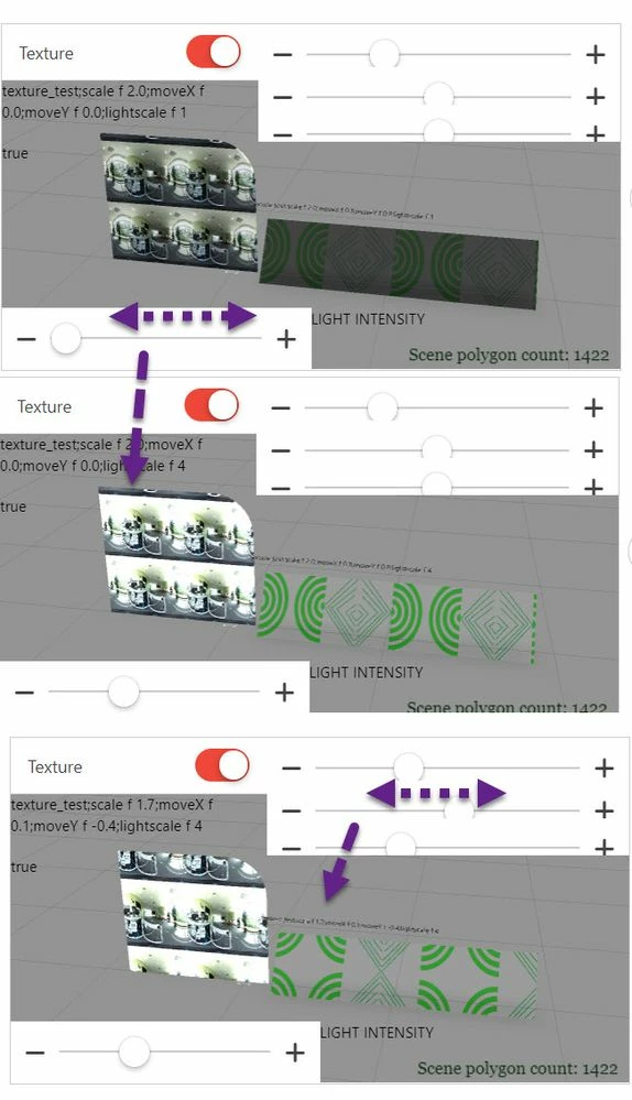

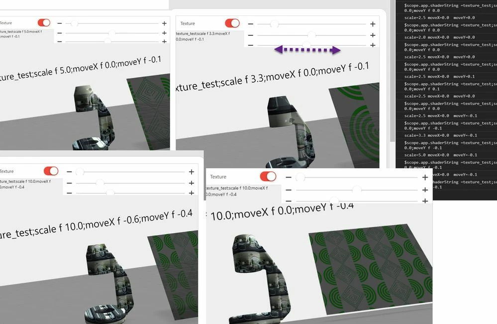

At the end I want to provide to this post  a sample project which demonstrate how to use the textures with shaders in Studio. Please, pay attention this is only an example which demonstrate the general principle. So far I now this way , works only on mobile devices. I did not get it work with the shader on the HoloLens.
I tested the project in preview on Android and on IOS. On Android and in preview mode it work fine. On IOS it works fine for the ModelItem but not for the 3dImage- but I think there we need to downscale the value of the light intensity:
 gl_FragColor = (ambientColor*lightscale + vec4(dProd)) *color ;// s
