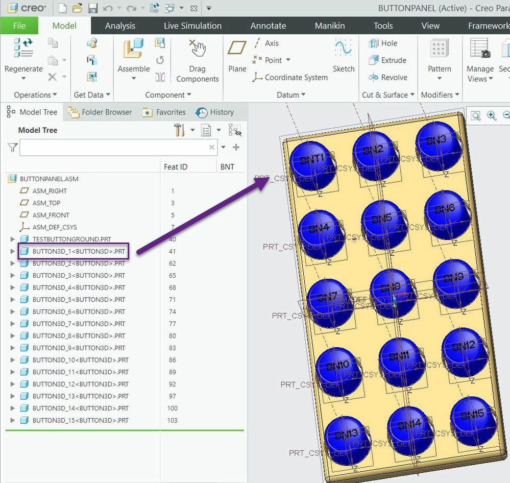

  1. Create a model with button and panel / it could be a panel with more buttons. In this example I used Creo Parametric for the 3d model creation – I estimated for this sample model I needed  30 – 60 Minutes .

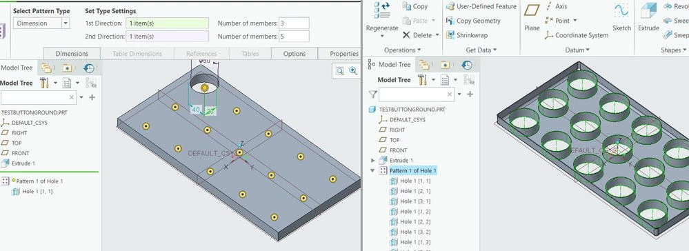

The assembly above consist of 3 parts, panel and button. The panel is a part with a pattern of hole feature - in case that we need a circular button. If we need a button with other shape we could use a pattern of cut features

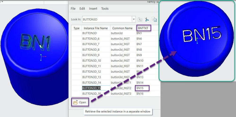

Here in this example I created a button which is circular and has a text which is a cut of the top surface. To have a different button’s I created a family table where a parameter for the text was added. I used the parameter in a relation to change the text in the cut.

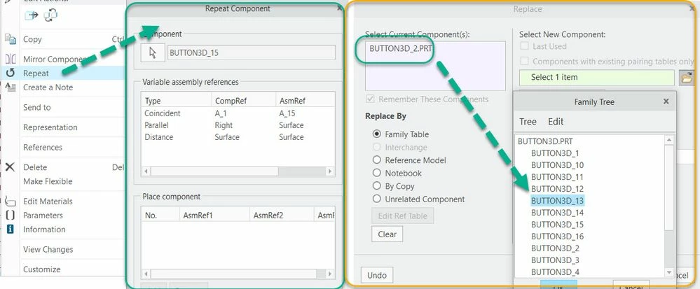

Later I added the panel in a new component as default placement and added to each hole feature a button as repeat component. After all components are added to the assembly (the generic part)  we can replace each component (the generic part - the part which defines the family table) by the family table instance - so to have a buttons with different texts. Above we can see in the picture that in the instance "BUTTON3D_15" we have the value “BN15” for the parameter BNTTXT  which is displayed in the button text.
I attached the assembly (created in Creo Parametric 6.0). You can open the button part (button3d.prt) and edit the family table - the values of the parameter BNTTXT - to have other text values for the different buttons. Then you need to verify and to regenerate the part. Please, pay attention, that the text should be should be not so long , because the button top surface is small

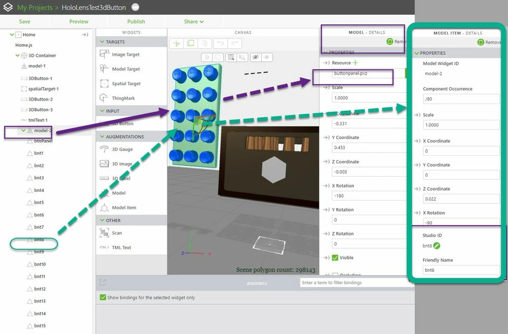

2.) Create a Vuforia Studio project for HoloLens device. For the button panel we need to add a new modelWidget and for each button we can define a modelItem widget:
To make the project now to work we need to define a JavaScript code. Here the code is define in the Home.js
