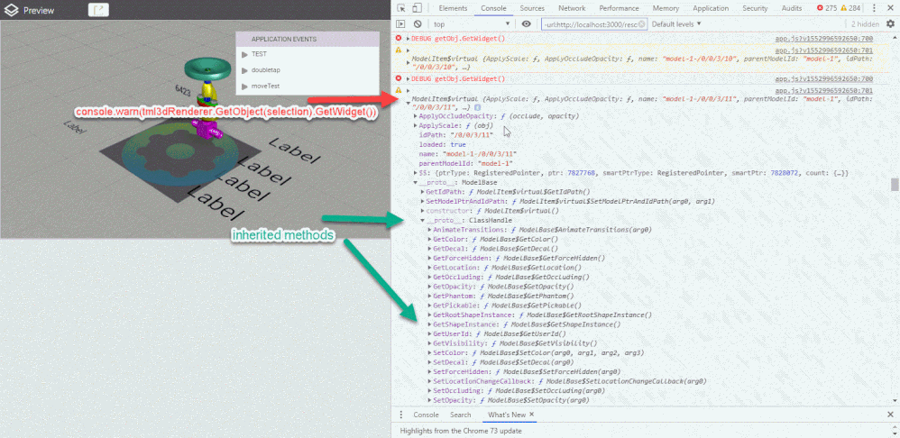

In Vuforia Studio Environment Extracting of data is possible only in Preview mode, because we have in preview mode the method tml3dRenderer.GetObject() where we can access a model object (a component) example:
let comp_widget=tml3dRenderer.GetObject(selection).GetWidget()
where the selection is some thing like "<modelname>-<compPath>" e.g. : "model-1-/0/0/3/2"
Then from the widget we can extract data:
 var loc=tml3dRenderer.GetObject(selection).GetWidget().GetLocation()
 console.error("DEBUG getObj.GetWidget()")
 console.warn(tml3dRenderer.GetObject(selection).GetWidget())
When we   explore  the different methods in the crome debugging console,  we will find methods to  get or  to set  properties. To extract data, we can use the get... methods.

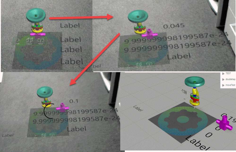

The methods of  tml3dRenderer.GetObject() seems currently not to work in Vuforia View on end devices (the tml3dRenderer object is a handle of the cordova vuforia plug in and it has a different implementation on the different end devices.In preview mode so far I know, the graphic is based on WebGL and Three.js)
Therefore we will be not able for example to get the data of a component selection on the end device. So means we need a way to extract data in Preview mode and make it available in the Vuforia view on the end device.  Here I did not find a methods to extract the original component name but I was able to create a list (json) with the position data ( I did not add color but this is possible to access it - e.g. tml3dRenderer.GetObject(selection).GetWidget().GetColor())

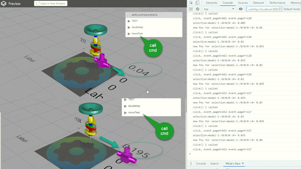

we can  assign the json to a variable e.g. $scope.COMP_LOCs
So later we can read the current position data on end device:
var selection_location=$scope.COMP_LOCs[l_currentSelection]
//read the location data from json varible console.log("selection:"+l_currentSelection+"->X= "+ selection_location.position.x);
//print it to console selection_location.position.x= round(parseFloat(selection_location.position.x) + 0.005,4)
//add 0.005 shift and round to 4 dec

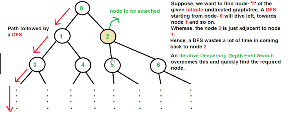

One possible algorithm is the deep first search:
To implement this I used the following javaScript code:

The code above has the following weak spot - I need to give the maximum depth (max_asm_depth) and the maximum possible branches (max_numb_comp_asm
The maximum depth currently in Creo assembly is 25 so that value which > 25 will not make a sense.
The value of  max_numb_comp_asm  in a flat assembly (only one level of depth) corresponds to the number of the components - the maximum number of branches on particular level of depth
The another possible algorithm is the breadth first search:

The code for the breadth first search uses also the parameters for maximum depth (max_asm_depth) and the maximum possible branches (max_numb_comp_asm)  - so means it have the mentioned  restriction. If we set a value which is large this will increase the time until the search is completed so therefore depending of the particular assembly we need to set the both parameter properly ( we need to be able to scan the whole assembly but to minimize the search time)
For different assemblies the first deep or first breadth could lead to better results. For example, for flat assembly structures the better approach will be to use the first breadth algorithm
But actually the performance is not so important here, because the search will be called one time and  then the json list should be saved.

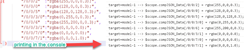

To read a json file form the upload folder we can use some code like this:
target='model-1'
$http.get('app/resources/Uploaded/' + jsonFile).success(function(data, status, headers, config) { $scope.compJSON_mod=data; // in this case the data is the received json object
angular.forEach(data , function(color, path_id){ $scope.compJSON_Data[path_id] =position; console.log("target="+target+" --> $scope.compJSON_Data["+path_id+"] = "+$scope.compJSON_Data[path_id]); });//end of the error function ////////// finish for each path_id }) .error(function(data, status, headers, config) {console.log("problem in the http will create a new ");

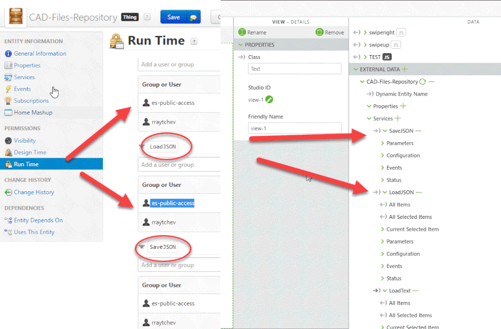

When we want to save data  (the generated json list) we need to use another workaround - we can use a thingworx repository. Following functions /events could be used to save and receive an json object to/from a twx repository:
// the methods SaveJSON and LoadJSON
// for the repository object should have
//run permision for es-public-access user
$scope.SaveJsonToTwxRepository = function(path, content) {
 $scope.$applyAsync(function() {
 $rootScope.$broadcast('app.mdl.CAD-Files-Repository.svc.SaveJSON',
 {"content": content, "path":path}

Here in this example the repository object is named "CAD-Files-Repository"
The Thingworx services should have run permission and it is required to be added in the external data panel :
So when we start the project in PREVIEW mode we can call the search for the assembly structure and save it then  to thingworx. In Vuforia View mode   then we can receive the previously saved json object from thingworx.
To check the current mode (if Preview or End Device)  we can use
if(twx.app.isPreview() == true)
it will  check if the current mode is preview mode or Vuforia View on the end device - here an example of the workflow:
