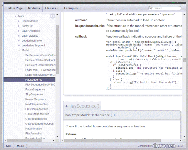

In the web-application-examples  directory we can find some sample files which could be a good introduction how to use this API. The documentation is the WebGLToolkitDevGuide_en.pdf  and also in html(doxygen) in the documentation sub directory:

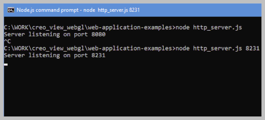

The CreoWebGL Toolkit requires a node.js environment. So  when we want to start it we have first to start the Toolkit server:
>>>node http_server.js [port]
The port parameter is optional and if we do not use it then it takes by default 8080 :
The next step is to open the localhost:port/ ExtractBomPVZ.html which implements  here our program

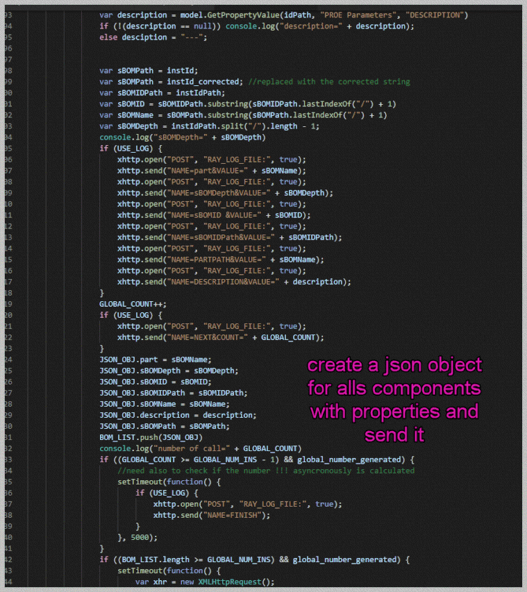

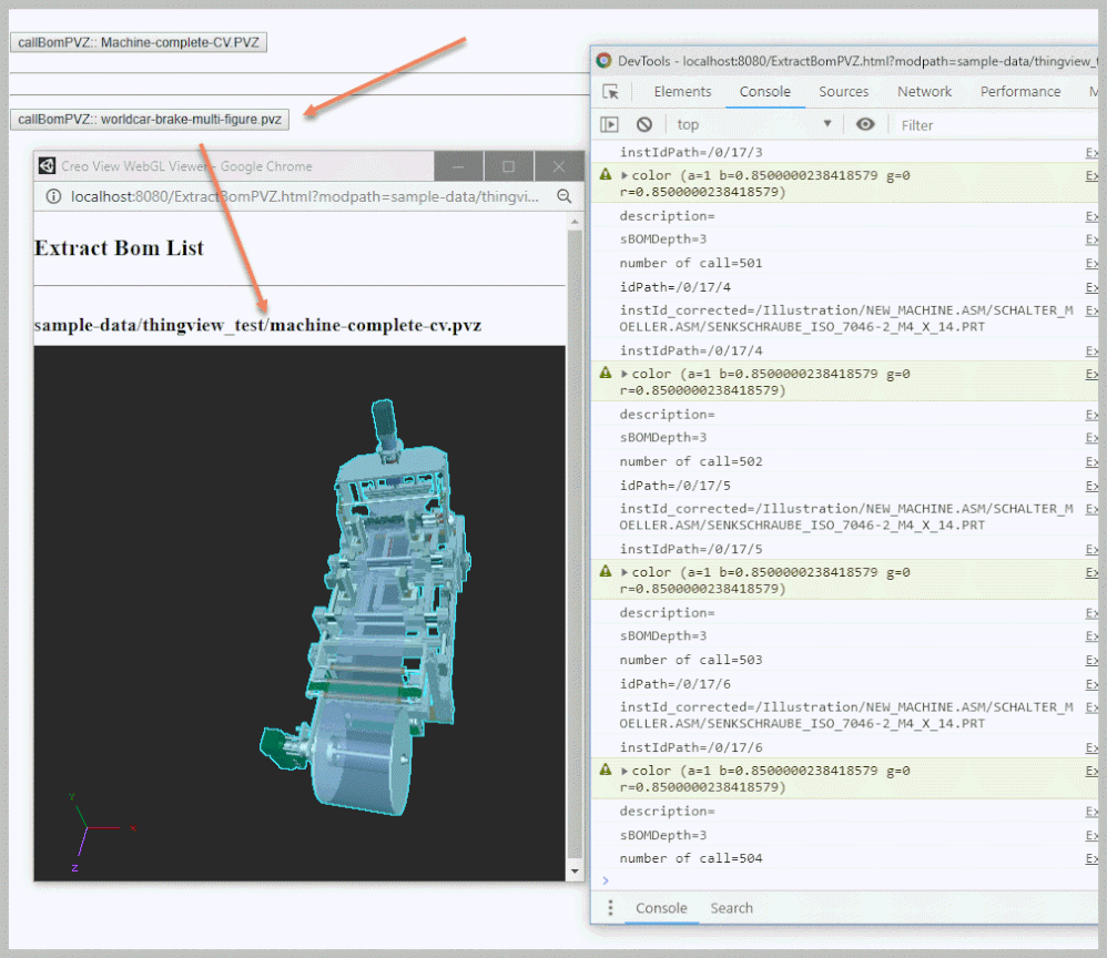

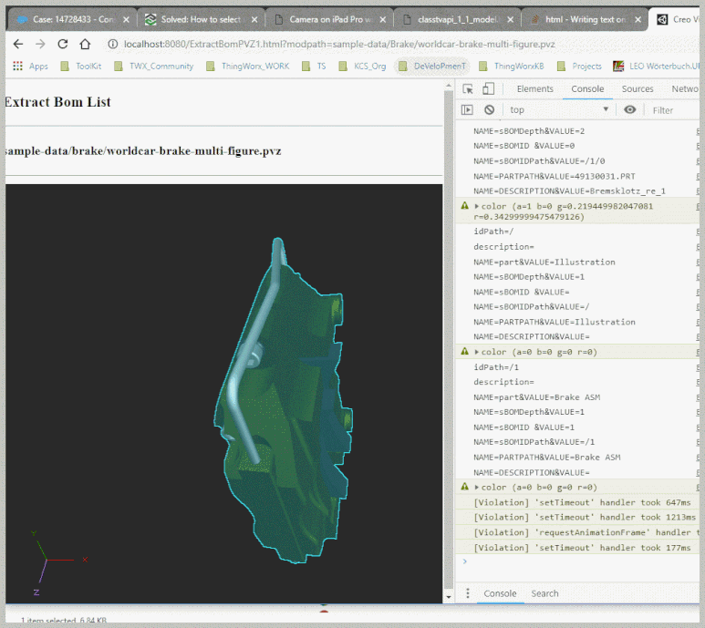

When we start the  ExtractBomPVZ.html and open the chrome debugging console (Ctrl-Shift-I)
We can call the Creo View WebGl Toolkit program above in chrome with a parameter which will specify a path of the .pvz model –> example:
http://localhost:8080/ExtractBomPVZ.html?modpath=sample-data/Brake/worldcar-brake-multi-figure.pvz
The program will selects all visible components and will print to the console the idPah, partname , color etc…

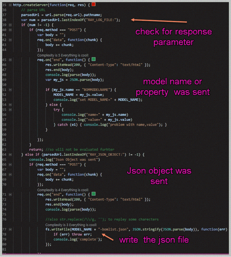

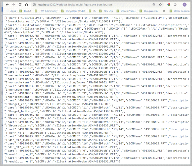

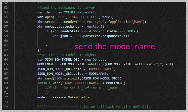

One problem we have here is that we could not print it to a local file because of the security restriction of the browser. A possible solution is to send the data back to the server e.g. as Json object and save the data to the server root directory. Later we can download these file if required e.g. calling the json:
http://localhost:8080/worldcar-brake-multi-figure.pvz-bomlist.json
To implement the creation of the json file we need  to change the CreoWeb.Toolkit html file. So our program  should send data to the server.  Additionaly we  also need to modify/extend the server - http.createServer() callback function to handle also the received data.
Also as next step we will extend  the Creo View Toolkit  program file by adding a XMLHttpRequest() . This request  will send the modelname and the generated json object to the http server
