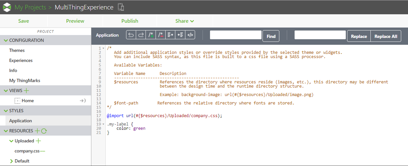

  1. Add the corporate css file (e.g. company.css) to your resources
  2. In Application styles add the following at the beginning (before any other css style entry:
@import url(#{$resources}/Uploaded/company.css);

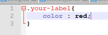

With the following content in company.css:

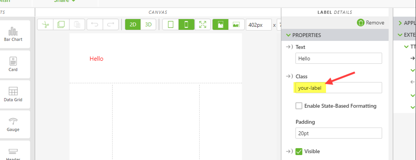

And this label definition:

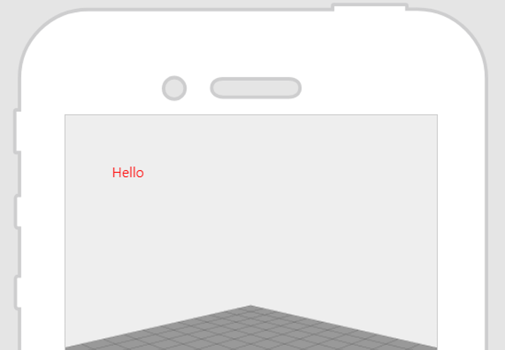

Produces this outcome (you see it in the editor as well as in the preview):
