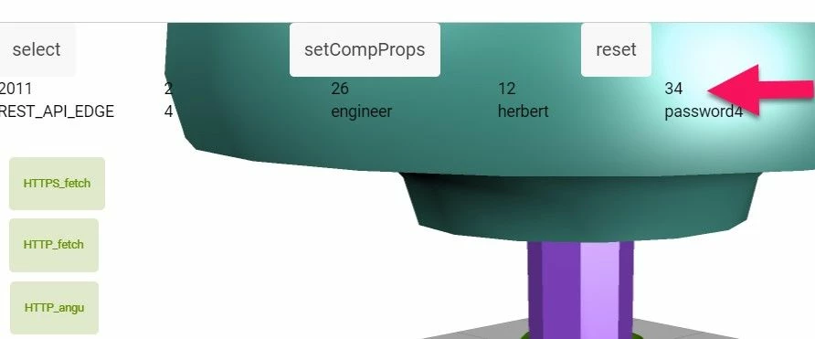

When I tested it - my observation was that https and http requests will work in Studio in preview mode.  But only the https request will work on both Android and IOS devices. The http fetch request will not work ...
This means trying to design a solution which will call javaScript on the Vuforia view where we will try to read data will not work / or at least  will not work  stable.

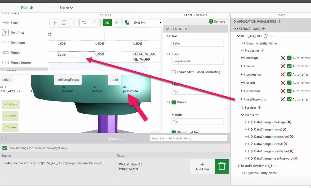

Therefore,  a better  way  is  /also it is the supported way /- to get (to bind)  the sensors data via the External DATA panel:
To achieve this goal , we need:
  • we need first to create a Thing with properties which could be displayed in the experience project.
  • The next step is to read the sensors and update the properties.

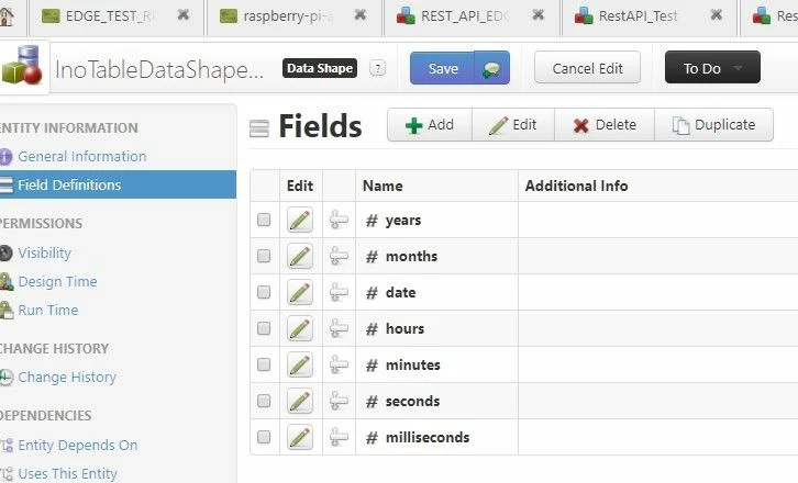

To be able to convert the json object to an infotable we need to define a datashape with the same fields -> corresponding to the json elements (here e.g  InoTableDataShape_Time1):

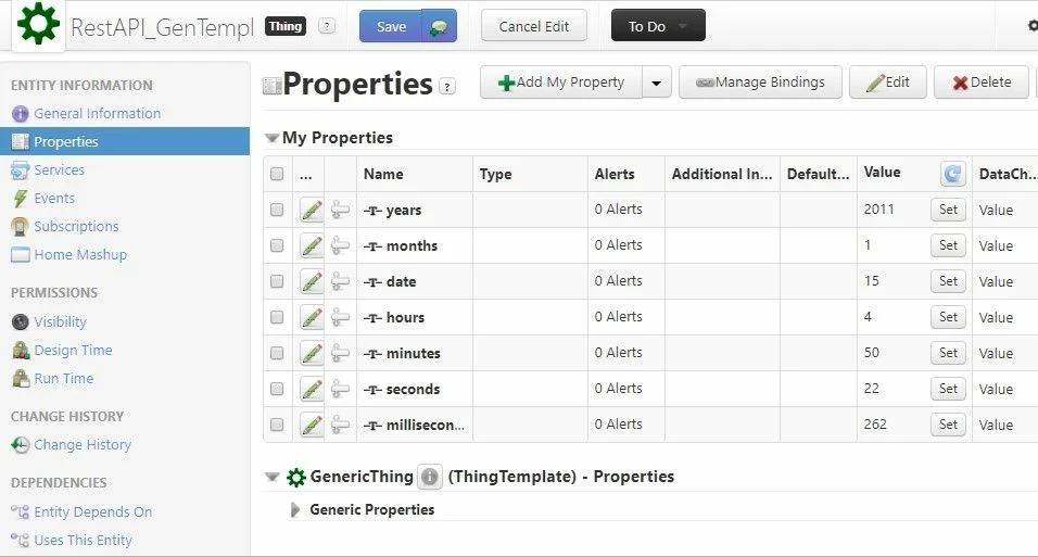

So every time when we call this service it will call the postman-echo web.side with some random data and will set the values of properties based on the received data  from the request. In this case the request returns the sent data (makes no really sense) but here is only important to demonstrate the principle how to call it. This should demonstrate how to request values from some edge devices (measurments) via REST API calls - supposing that the edge device supports  REST API call. (For example we can setup some Arduinos, Raspberry ,  ESP8266, etc...  as Web Service supporting REST API calls for reading of measurment values)

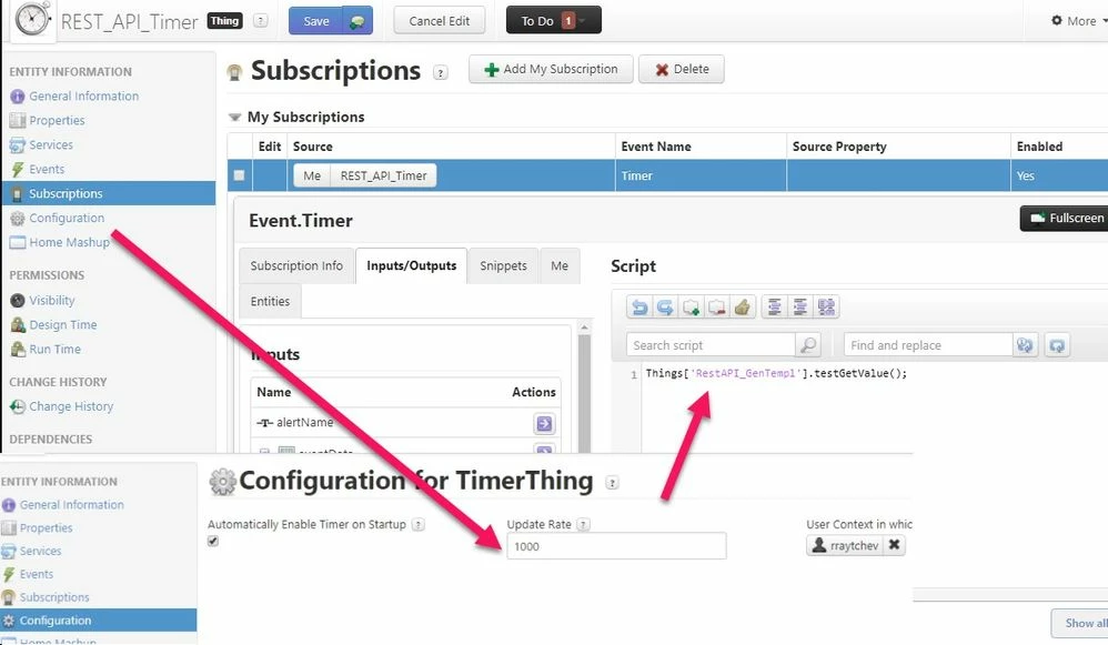

Now we need to create a timer object  which will call call the service  for  an particular interval (here 1 sec /1000msec)  -> the used  service is here testGetValues() according the definition above.
this will update the values of the property and we can see the updated property  in Vuforia Studio.
