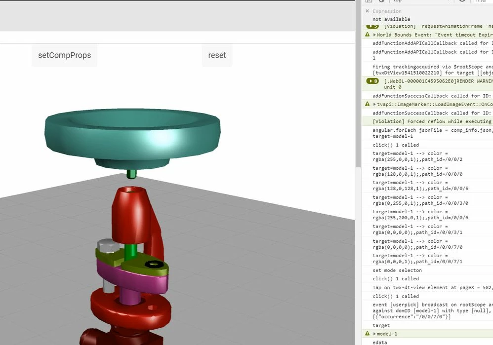

If  we use  PICK_COLOR  = "rgba(255,0,0,0)";
It means that this color (red) is set for a selected component. Here the one additional detail is the last argument - which have a value of 0. Means alpha channel =0 - or full transparence. On the most mobile devices it will hide the selected component, but this is not supported techniques and we have to use always color with alpha channel >0. / transparent but still visible/
Calling of the tml3dRenderer.setColor(…, undefined); will set the component color back to default - example:
tml3dRenderer.setColor(‘model-1-/0/0/3/2’, undefined);

So when we start for this particular model the test code it will change the display of the model according to the setting of the comp_info.json  file:

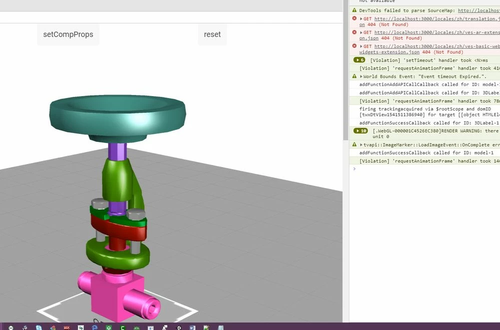

The example above will set to the component the correct values of the color but with alpha channel 1.0 and will interpret the original alpha value from the file as setting of the hidden property to true.  Does this make sense? Yes if we later set the hidden property to false then the color setting will be applied according to the definition from  the json file

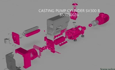

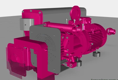

I wrote some Python code to turn an arbitrarily long list of component IDs ("0/0/2/0","0/0/2/1", etc) into a string with the correct syntax for me to paste it into the Home.json file to create a bunch of model items. After working out a few glitches (such as extra commas) I got it working, so that it actually creates about 25 model items and applies things like unique click expressions & color to them. However, here's the issue I have: If I enter the coordinates as x,y,z & rx,ry,rz as all = 0, it overrides their correct positions. They end up in all sorts of wrong orientations. I tried it again without listing these parameters at all, and the orientations of the model items were even worse.
Somehow when a model-item widget is created in Vuforia Studio the normal way (click and drag, or entering the component ID) Vuforia Studio displays the x,y,z coordinates all as 0's, but the actual Home.json file is populated with coordinates extracted from the PVZ file. If I could get these coordinates somehow, I could insert them into the string before pasting it into the Home.json. I just can't figure out how. I know Creo Illustrate lists a bunch of parameters when you highlight parts, but coordinates are not included. I haven't had any success "decoding" pvz files either. Searching for this is how I came across this tip you shared.
What do you think might work for this?
It's super cool when I can create 25+ model items very quickly and accurately, all with colors and unique click expressions like app.displayInfo("0/0/0/2"); This allows me to use a function "displayinfo" to update 3D labels with parameters associated with "0/0/0/2" such as part description & part number. But it's not going to work if the exploded view of the product, and the animations, all show components in the wrong positions & orientations.
