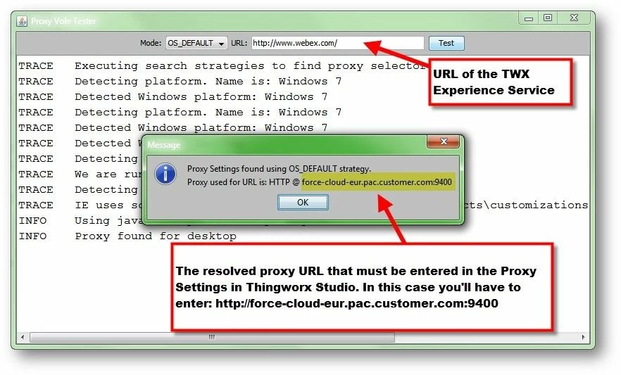

  2. Start the proxy vole application in a command shell using the following command:
    java -cp ./proxy-vole-1.0.1-jar-with-dependencies.jar com.github.markusbernhardt.proxy.ui.ProxyTester

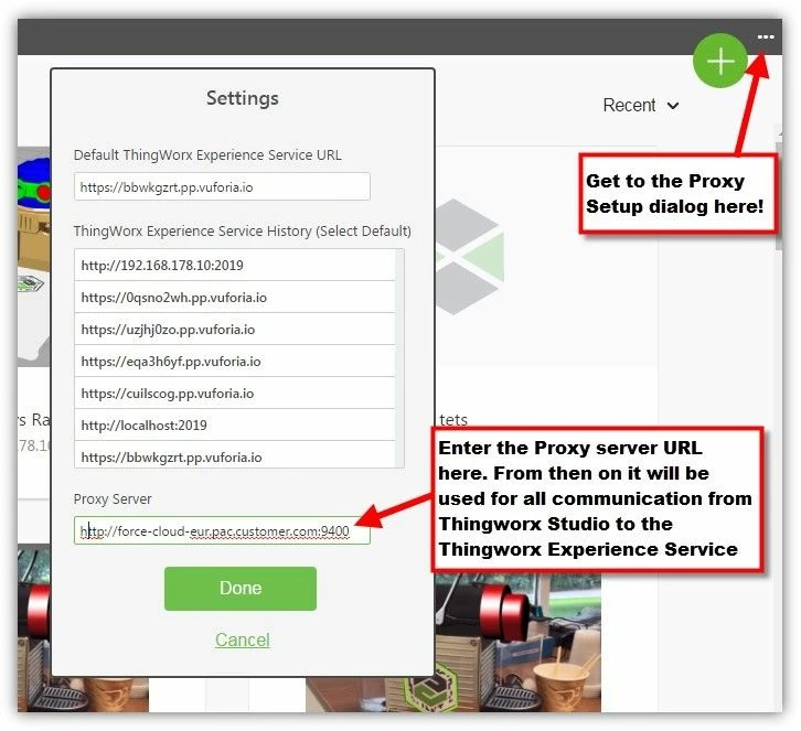

  3. Enter the following in the dialog box:ProxyVole.jpg4. Specify the resulting proxy URL in Thingworx Studio:
That's it!

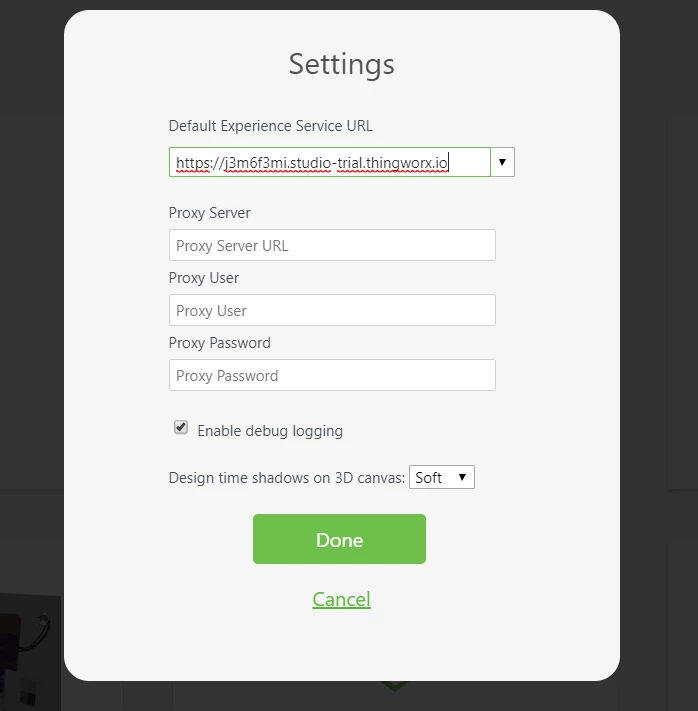

  4. The Settings dialog in Studio has evolved and now provides the ability to specify user name and password beside the proxy server URL.
    Settings dialog with proxy URL/User/PasswordSettings dialog with proxy URL/User/Password
