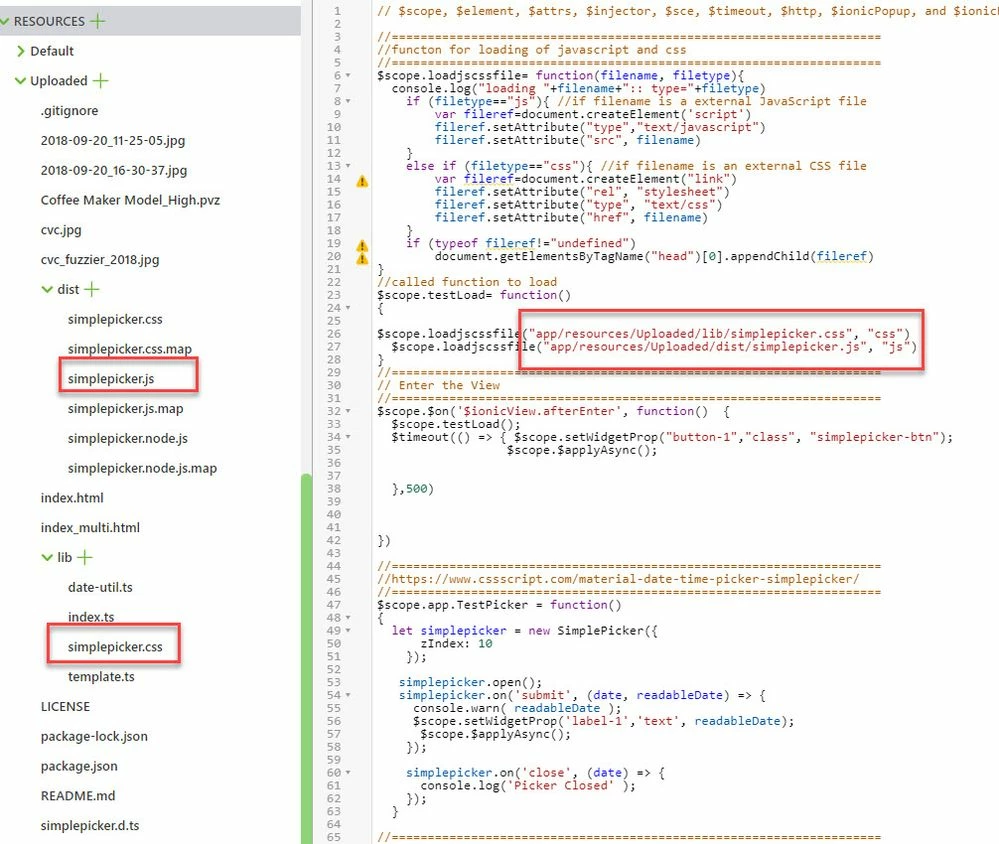

Here in this example the library (data-picker) is copied to  the Studio Project download folder and it javascript code will   load the lib and defined a function which is called from button
First step is to define a function which enables to load javascript and css from a file / project folder:

// this function will load the simplepicker javascript lib and the css lib
$scope.testLoad= function()
$scope.loadjscssfile("app/resources/Uploaded/lib/simplepicker.css", "css")
 $scope.loadjscssfile("app/resources/Uploaded/dist/simplepicker.js", "js")
In this example the $inoicView.afterEnter (after 2d/view  is loaded) event is used to load the library.
The function for the picker call is defined -  $scope.app.TestPicker()- which is called from a button .
$scope.$on('$ionicView.afterEnter', function() {
 $scope.testLoad();
 $timeout(() => { $scope.setWidgetProp("button-1","class", "simplepicker-btn");
 $scope.$applyAsync();
 },500)
//https://www.cssscript.com/material-date-time-picker-simplepicker/
// function called from a button
$scope.app.TestPicker = function()
 let simplepicker = new SimplePicker({
 zIndex: 10
 simplepicker.open();
 simplepicker.on('submit', (date, readableDate) => {
 console.warn( readableDate );
 $scope.setWidgetProp('label-1','text', readableDate);
 simplepicker.on('close', (date) => {
 console.log('Picker Closed' );

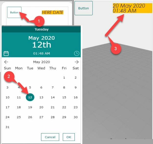

When the picker is closed after date was selected - the javascript code will set the selected value to the text property of a label widget (label-2).
The javascript and the style (css)  implementation was copied to the resource folder:
Now the   simplepicker could be tested and it has the following appearance in preview mode:
