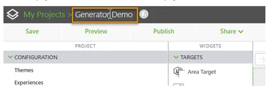

You can rename a project to avoid overwriting an existing published project with the same name on your Experience Service.
To Rename your project, open the project you want to rename and click on the project name in the header bar; the field will become editable. For additional information, see Rename a Project
Here are a few things you need to consider when renaming a project:
  • Renaming an already published project creates a duplicate of the project that is unpublished; it does not rename the already published project on the Experience Service
  • To avoid having multiple copies of the same project on your Experience Service, unpublish the original project before renaming it and publishing it.
  • Once you rename an already published project, and then publish the renamed project, a new QR code is created (different from the originally published project's QR code)
