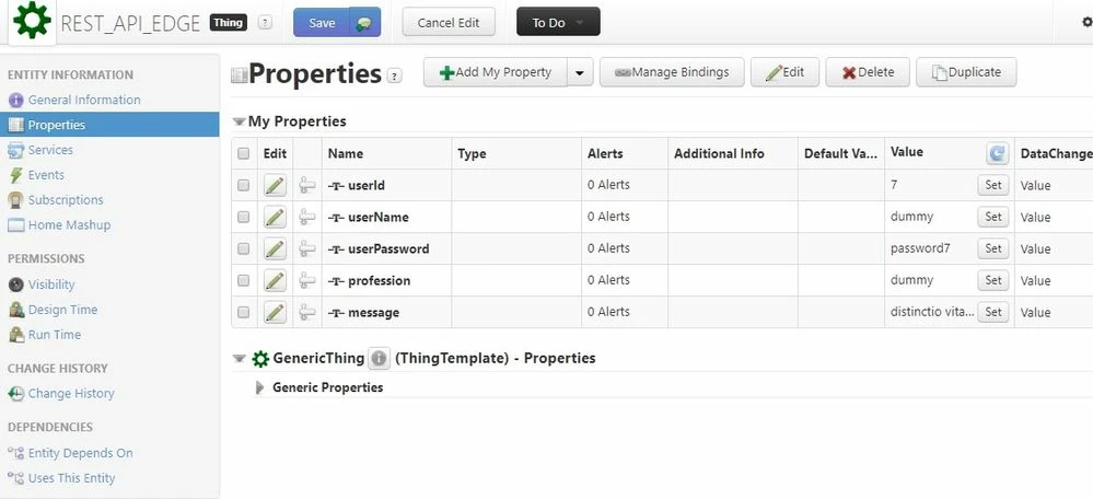

 When we review the code above we can see that there is function “setPropValue” which should set a value to a particular property. Here the twx server:port is mxxxxx7o.studio-trial.thingworx.io:8443. The Thingname is  “REST_API_EDGE”

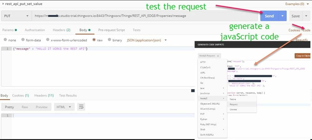

The code was generated with the REST API client POSTMAN. We can use this tool to test some Rest API calls in the POSTMAN GUI , where we could use some more confortable functionality for testing and debugging . When the call is working in the POSTMAN UI we can export it to different programming formats (javaScript, nodeJs etc. - means it  will  generate here a  javaScript code for postprocessing. When we start the script (above) we can verify that the property values will change every 5 seconds.

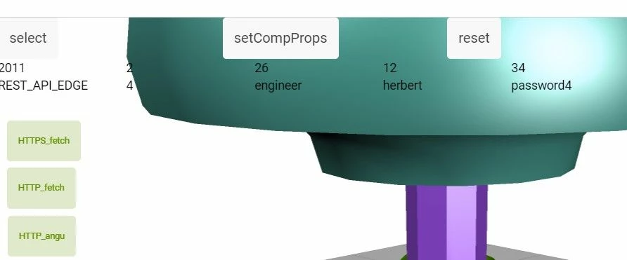

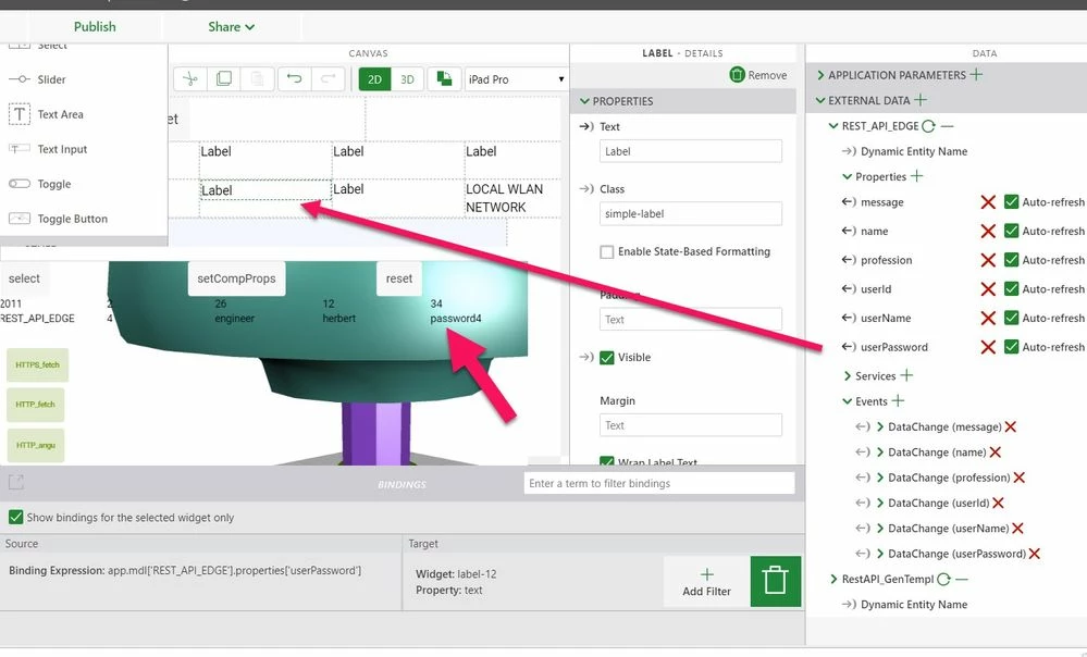

The best way now to bind the data in Vuforia studio is via the External DATA panel
Afterwards  we can test in the Preview and later on the end device:
