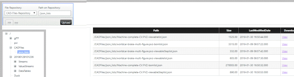

In this example the json files are saved already  in a thingworx repository (means a thing form template FileRepostiroy) e.g.  "CAD-Files-Repository" :

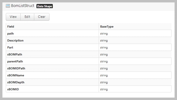

1.)Create a service for the BOM List /InfoTable

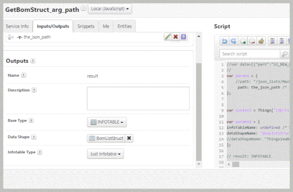

  • edit the CAD-Files-Repository thing and create a new service named  "GetBomStruct_arg_path"
  • set  the BaseType : INFOTABLE .
  • Set the DataShape property of the service - > here to BomListStuct -> this datashape need to be created  first . It should have the following Fields / property (all String type):
  • create a service input parameter "the_json_path". Using this parameter we can past the repository path to the service
  • edit the java script . We can past the following script (see the comments in the script area)

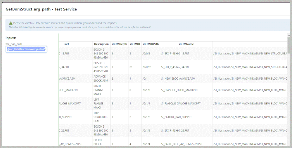

Test the  service:

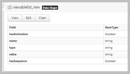

2.)Create a service for the BOM List /InfoTable (steps are similar to 1.)
  • edit the CAD-Files-Repository thing and create a new service named  "getViewableList_arg_path"
  • set  the BaseType : INFOTABLE . Set the DataShape property of the service - > here to viewablelist_new -> this datashape need to be created  first . It should have the following Fields / property (all String type)
  • Create a service input parameter "the_json_path". Using this parameter we can past the repository path to the service

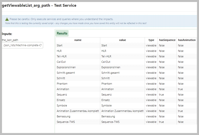

  • Test the  service:
