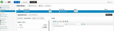

  • Create a service for the Thing with text input parameter(Test) and add the below code to update the TestProperty value:2.jpg

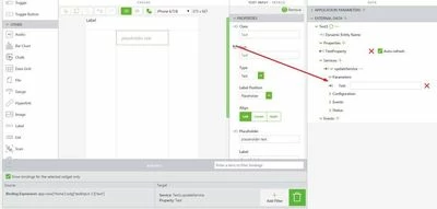

  • Now, bind the Text property of the ‘Text Input’ widget to the Test Parameter of the service as shown below:3.jpg

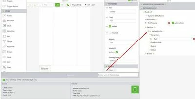

  • Bind the Click event of the Button widget to the Service to update the value of Thing property in ThingWorx4.jpg
  • Test the experience by clicking Preview. Enter text in the Text Input widget and click the button. The Thing property should then be updated.
