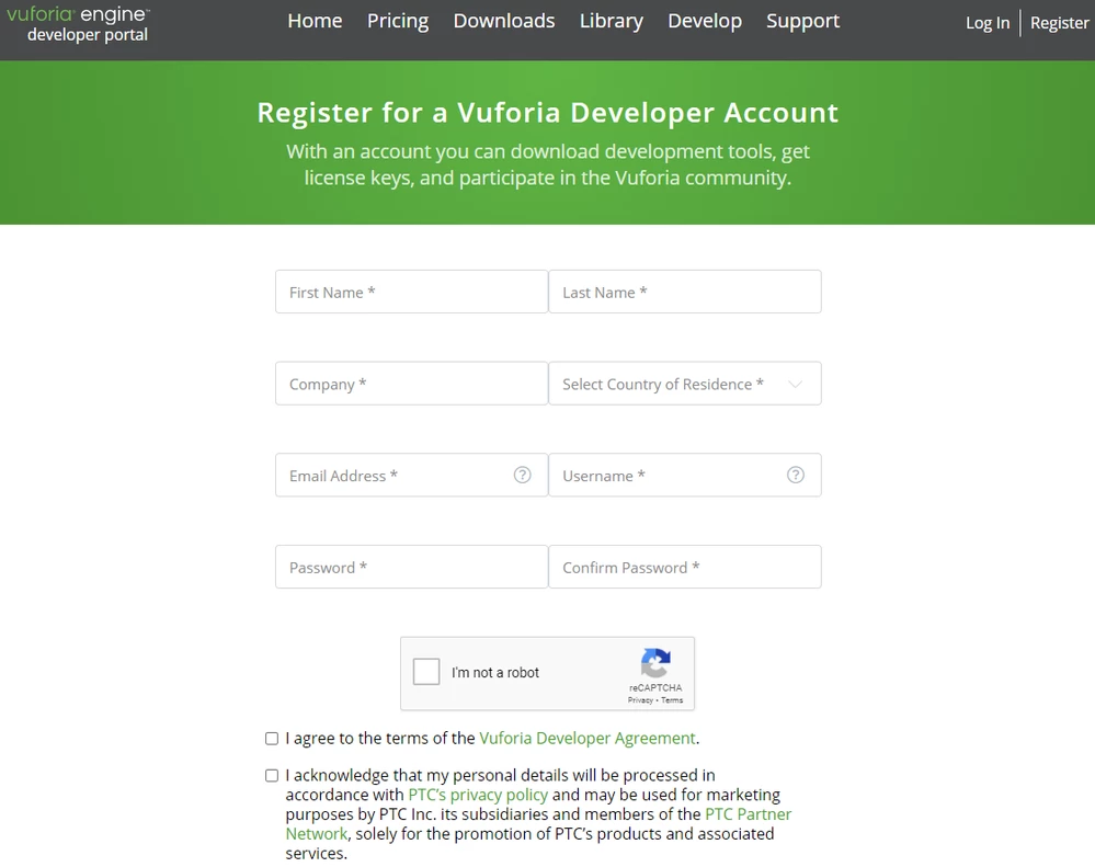

Step 1: Create a Vuforia Engine Developer Account
This account is separate from your regular PTC support account and is required to generate Area Targets.

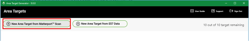

Creating an Area Target using the Matterport Pro2 Camera:

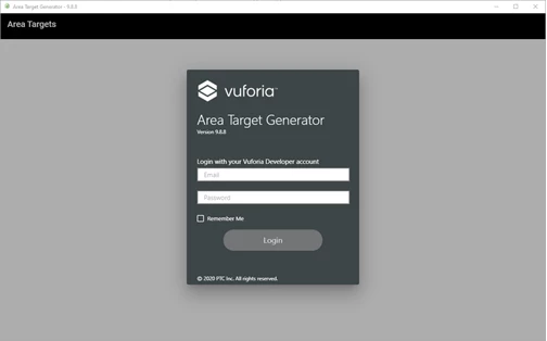

  1. Log into the Vuforia Area Target Generator with your Vuforia Developer Credentialsimage.png

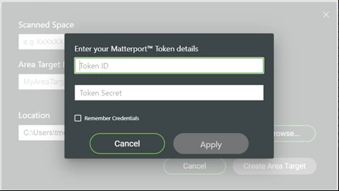

    1. See Retrieving Models with the Matterport™ API Token for instructions on obtaining your token ID

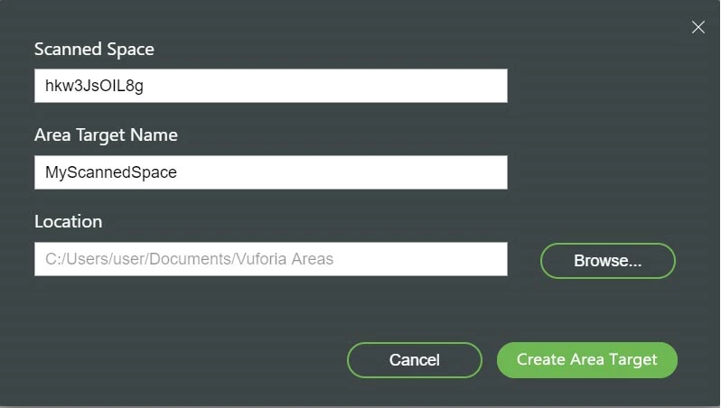

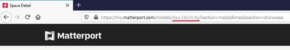

    1. The Scanned Space field is the Matterport™ SpaceID and a unique 11-digit ID that is associated with your individual scans.
    2. Find the unique ID of your scan by opening the scanned space from your Matterport™ account.image.png
    3. Copy the entire URL, or just the SpaceID portion as illustrated and paste it into the Scanned Space  field.
    4. Area Target name must not contain any spaces
  5. Select Create Area Target to generate an Area Target of your scan.

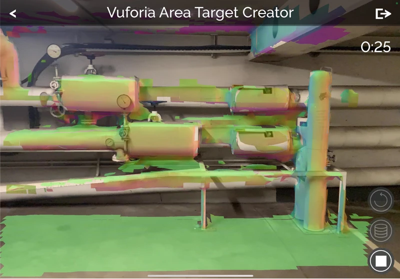

Creating an Area Target using the Vuforia Area Target Creator (requires internet connection):

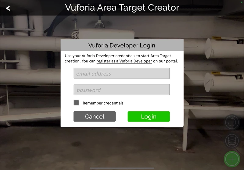

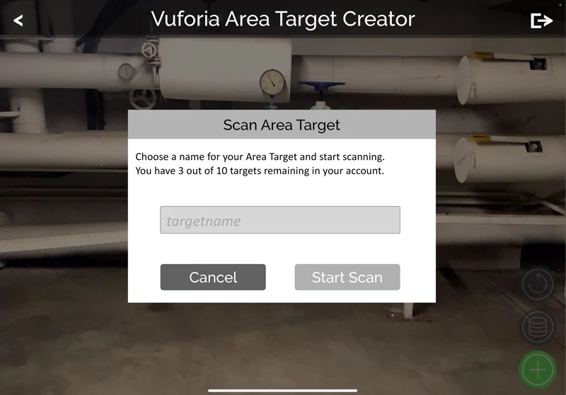

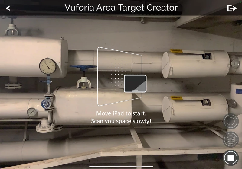

  2. Select the Plus Button to create a new scan and enter a scan nameimage.png
  4. Press the Stop Button to finish the scan

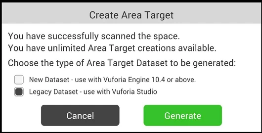

  5. Select the Legacy Dataset option, then select Generate to generate an Area Target databaseimage.png

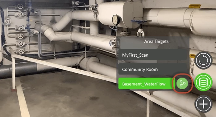

  1. Share your files to your Studio authoring machine
    1. Press the Container button and swipe one of the Area Target datasets listed to the left. A share icon will appear.

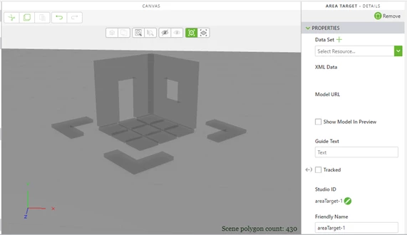

  2. Select the green plus button next to Data set
  3. Browse to the location of your <target_name>.zip file and select open
