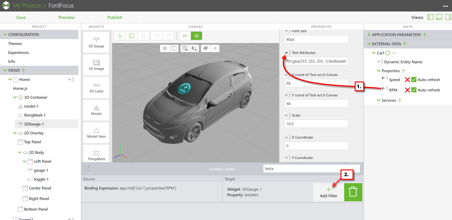

Here is what I mean in practice:
Step 1:
Step 2:

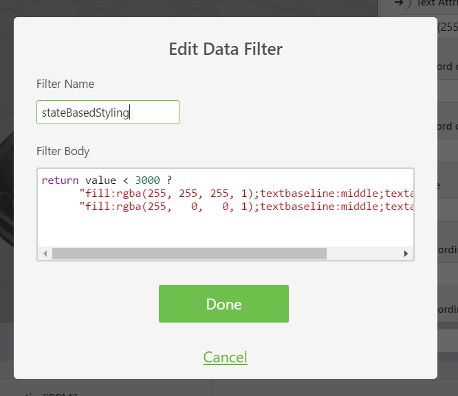

Here is the stateBasedStyling Connection Filter content:
return value < 3000 ?
   "fill:rgba(255, 255, 255, 1);textbaseline:middle;textalign:center" :
   "fill:rgba(255,   0,   0, 1);textbaseline:middle;textalign:center" ;
value is a key word and represents the value on the connection before applying the filter function. The returned value is the one that is used in the bound-to attribute. I found that the expression has to be a one-liner (technically), i.e. you have to start your expression with 'return' and can't do something like:
if(value < 3000) return "fill:rgba(255, 255, 255, 1);textbaseline:middle;textalign:center";
else return "fill:rgba(255,   0,   0, 1);textbaseline:middle;textalign:center";

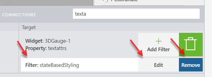

Resulting Filter in ThingWorx Studio:
You can add multiple filters but I didn't check yet in which sequence they'll be evaluated (top-to-bottom or bottom-to-top).
