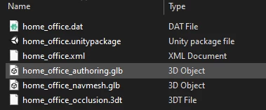

It's great to have support for occlusion on Area Targets!
But how to make it happen?
How to get the <target_name>_navmesh.glb file? (https://support.ptc.com/help/vuforia/studio/en/#page/Studio_Help_Center%2FWidgetAreaTarget.html)
Is it supported by ATG 9.8.8 ? (https://developer.vuforia.com/downloads/tool)
Thanks in advance
tmccombie21-Topaz IAuthor
June 30, 2021
@dsgnrClarK
<target_name>_navmesh.glb should be included in the output from the area target generator. You'll need to include it in your zip that you upload to Studio. Here's a screenshot of the output from using the VATG app:

Thanks for the reply.
Here is another question,  will  the Support for occlusion on Area Targets included in Vuforia Area Target Creator APP?
Thanks a lot.
August 4, 2021
@dsgnrClarK Yes, this will also be available for Area Targets created using the Creator App for iOS
