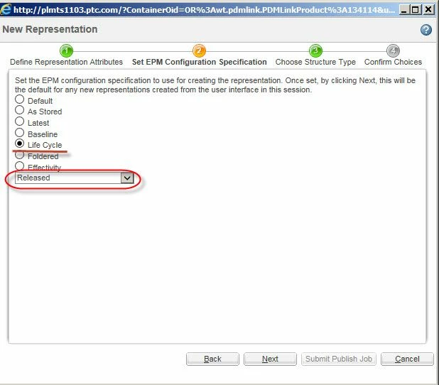

Dec 12, 2018 4:54 AM UTC
Hi Tom,
Are you trying to publish CAD objects with the following Config spec by default? (see screenshot below) or do you want to publish those CAD objects with 'Latest Iteration at Current Revision' of each dependent model?
I once worked with you when creating the publish utilities publishing jobs based on EPMDocument's object identifier(OID) from a CSV in the article CS211115 and just want to help you creating a article with this custom publisher
Life Cycle Config spec:LC.jpg
18-Opal
Mar 8, 2019 12:45 AM UTC
Tom,
If this is still an issue I think I have a solution for you.
If I understand the problem correctly you want a snapshot of the drawing and the required dependencies in their latest configuration at the moment the drawing is released.
If this describes what you want this is very doable.
Have you tried using the APIs to create a ManagedBaseline that consists of the Drawing and all Required dependencies using Latest ConfigSpec. If you create this baseline the moment the drawing is released you'll have your snapshot.
When you publish you can reference the Baseline either using the GUI or if need be using the APIs.
When you publish using the APIs you pass the ManagedBaseline to the doPublish method by using it to create a BaselineConfigSpec.
Hope this help and sorry for the slow reply.  I've been out of the Windchill coding scene for a while but I am back in the game again.  If you know anyone who needs help let me know.
