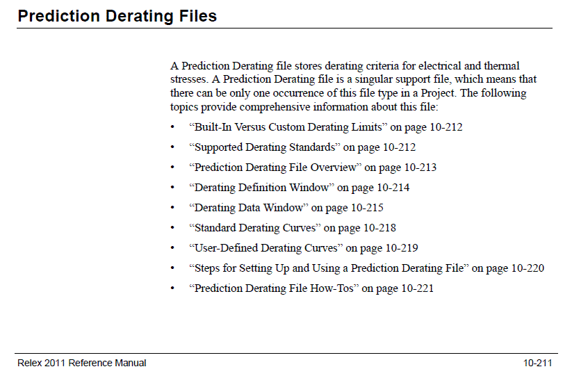

Hello!
In Relex 2011 Reference Manual (consists of 3186 pages) there is chapter "Prediction Derating Files" (page 2041), look there.
"Windchill Quality Solutions (Relex 2011) Reference Manual - English" it is possible to find here: https://www.ptc.com/view?im_dbkey=118192
