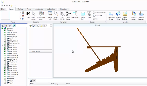

To get started, you’ll need to open a model within PTC Creo View.  To do this, go to “File/Open”, select “All Types” below the “File Type” dropdown, and choose a model.  In this example, we are going to follow along using a chair assembly.  At first, the screen will appear blank. This is the default behavior which  speeds up the part loading process. The model tree on the left allows you to interactively set the visibility of the assembly components. To make the full 3D model appear, select all of the boxes in the left column menu by clicking the top box in the upper corner.  If you want your models to always display when loaded, you can configure this in the Creo View options menus.

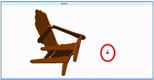

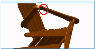

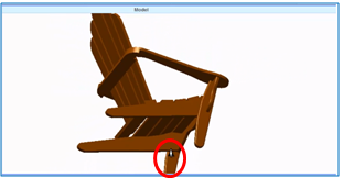

Next, let’s “fly” about the model. This mode of 3D scene navigation enables you to bring the model closer or farther from your view and to move to the left and right. At first this may seem a little tricky, but once you’ve worked out the basics, it allows you to smoothly interact with and view the model by moving your mouse in the corresponding direction. To familiarize yourself with these motions on screen, right click and hold the mouse button. The cursor changes from the normal 2D arrow to an icon of a spaceship to remind you that you’re in fly mode.  Moving the mouse up  brings  the model  closer to you, moving  it down pushes the model away, moving it right moves the model to the left, and moving the mouse to the left  brings the model to the right.
Panning & Zooming

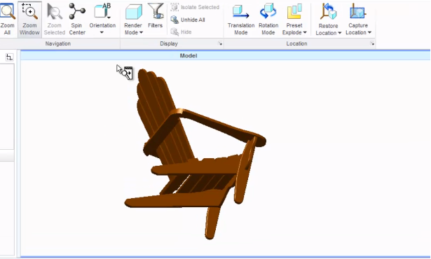

Next, let’s practice “zooming” (also known as scaling) the view of the model and panning the location of the model.  There are multiple ways to zoom in and out;  the easiest way to is to use the scroll wheel to increase or decrease the scale factor.  Another method is to press and hold the control key while pressing and holding the scroll wheel in place and moving the mouse.  If you don’t have a scroll wheel mouse press and hold the middle mouse button and the control key while providing trackpad input. Note that for all of these methods, the model will zoom away from the current location of the mouse in the view window. So if you want to zoom directly to the center of the model, move the mouse to the center of the window.  Alternatively, you can use the “Zoom Window” feature in the navigation bar. With the mouse in the main 3D viewing pane, use the left mouse button to drag a selection region over the object and then select “Zoom Window.” This will zoom to the selected location and center the view over that region.    If you want to reset the view, use “Zoom All” to make the entire model visible on the screen again. To “pan” the object about the viewing window, press and hold the shift key and the scroll wheel at the same time while moving the mouse. Again, if you do not have a scroll wheel, hold the shift key while holding the middle mouse button and move the mouse or use the trackpad.

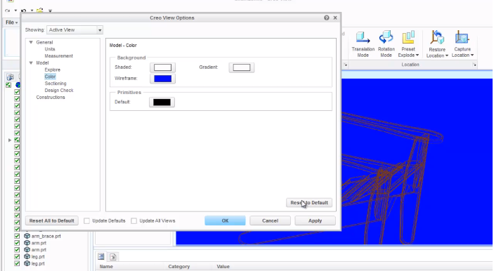

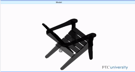

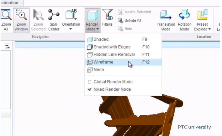

“Rendering” is the process of making the objects in the 3D world visible. Like an artist renders a painting or drawing, PTC Creo View takes into account object shapes and colors, lighting conditions, and the location of the virtual camera.  There are multiple options for rendering the color and display type. To change the model display, select the “Render Mode” button in the navigation bar.  In this example, I’m changing the chair model from “Shaded” to “Wireframe”. To change the background color in the main window, right click and select “View Settings” at the bottom of the pop-up menu.   This brings up the Options dialog box.  In the left menu column select “Color” below the “Model” header. Within the center menu area, select “Wireframe” as the background (since that is how we are currently rendering), select a color, and then click “Okay” and “Apply”. To change the color back, click “Reset to Default” and click “Apply”. Close out of this screen to return to the main viewing window.

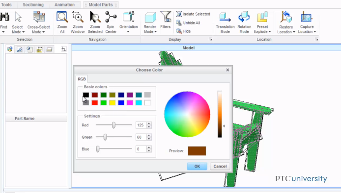

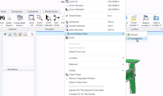

To change the color of the actual model, first change the “Render Mode” back to “Shaded”. Select the entire feature again, right click, and select “Color”. In this example, I am changing my chair from green to black. Should you want to add transparency, highlight all of the features, right click your mouse, and select “Local Display Style” and “Transparent”.
