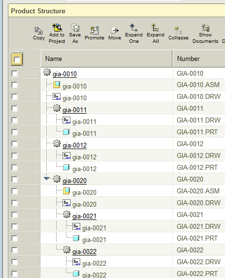

How do you search for all the drawings of the subassemblies of one model?

Hi Nicolas
f.e. you can open the WtPart Detailpage of the Top-Assemply
In the Bottom of the Page, you see WT Part -Structure.
Here you can show all drawings if you checkmark the upper left Main Button and press "Show documents".
Or, if you use specific actions as "Add to workspace", you can add all related drawings of a Main-Assembly in a List.
