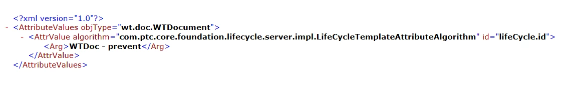

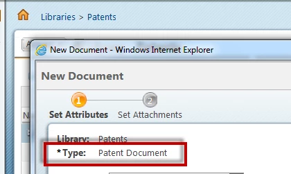

* Enable all sub types that users need to be able to create anywhere
* In each context where you do not want certain sub types to be created, create a OIR with just the Lifecycle element - specifying a lifecycle that doesn't exist. We label these as "Prevent" OIRs.
o If in any context there is only one remaining type, then the drop-down for type selection disappears and the user has no choice. This is the situation we have for many special-purpose libraries in which only one document type can be created.
examples[cid:image002.png@01CF7E3D.B78B0580]
[cid:image003.png@01CF7E3D.B78B0580]
