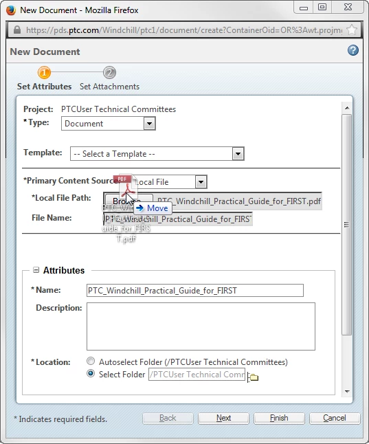

Can't wait for Windchill 10.2_M020? Try the built-in drag-n-drop features of Firefox and Chrome. I have noticed you can drag-n-drop files on almost any Browse, Upload or Add button in both Firefox and Chrome. Yeah, including Windchill. In fact, I dropped the attached image on the Add button in the PTC/USER portal while creating this message.
