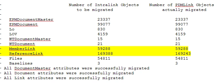

Feeling pretty good with the results of a test migration of Intralink
3.4 to Intralink 10.0
One thing that's not clear are the line items "MemberLink" &
"ReferenceLink" shown below in yellow. Can anyone help me understand
what exactly they represent? Is there anything I should try and clean
up prior to a migration? I'm concerned that the number of
"ReferenceLink" objects does not match the quantity of objects to be
migrated.
The documentation states that this data loader "will migrate Intralink
3.4 dependencies to Windchill PDMLink epmmemberlink or reference link.
No dependencies from or to the Intralink objects that can be migrated as
WTDocuments are migrated."
Thanks in advance,
