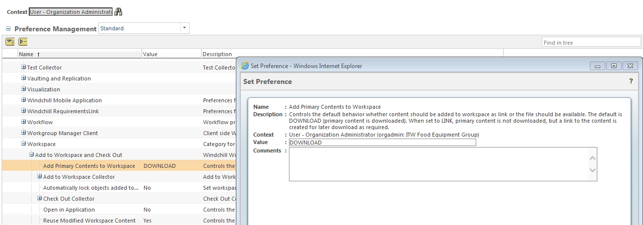

I want to change the default for the primary content when adding items to a workspace from "download" to "link".
How/can I do this change in the default for 10.2?

John,
This is a preference that can be set for Users individually or at the
Site level for all users.
For individuals: Go to Quick Links --> My Settings --> Preferences and look
for "Add Primary Contents to Workspace" under Workspace --> Add to
Workspace and Check Out. Change the value from DOWNLOAD to LINK
For the entire site: Go to Site --> Utilities --> Preference Managerment
and look for the same preference. Here you can lock the preference so all
users have to use this preference.
Hope that helps.
