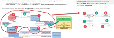

Now - to properly use the data model to do this reference the following CS article: https://www.ptc.com/en/support/article/CS153902
Specifically this section I've circled.  It translates to the table & join setup below.  What you'll notice is that the link between the Workflow Process and Control Branch is further explained in the post it note.  The businessObjReference value from the Workflow Process is "stored" in the Control Branch table's ID2A2 column, which equates to the Persist Info.Object Identifier.Id in query builder tables, however, in the Control Branch table it doesn't include the type prefix.  In your case 'VR:wt.part.WTPart:'.  And if you try to make a join between them you'll see there is no 'businessObjReference' join type you can use.
To get around this I simply put in a criteria that says the Control Branch OID, plus the type prefix, must equal the 'Business Obj Reference 1' column value from the workflow process.
When you run this report then it pull the part data no problem.  It does return duplicate rows (one for the part result and one for the Workflow Process result so I'd say you have to tick the box for "Distinct" on the report properties page.  I hadn't figured out a way to have it return only one row without using Distinct, but hey close enough for free help I'd say.  I did try setting the Part Latest Iteration = True/Yes/1 but that didn't affect it.  I think it really is just because you're returning results from two different tables that don't actually have a Join between them.

As in the picture above left, business object reference is the only reference to the primary business object on workflow process. It seems to contain a version reference to last iteration. On the right is the sample result of the query - and When I use this BO Ref from the table in Windchill Part Details URL as oid-parameter, the last iteration of the WTpart is displayed.
I my second test, verifying my approach, I am using using the BO reference 6117884855 from my first report as branch identifier parameter of the query and limiting the result to last iteration. This works well and displays the information that I would like to show in the first report!
I am not able create a query report, which combines these two reports, because of the format difference of the primary object reference and the branch id. I am trying with the offered java string methods and database functions to separate the number, but not getting it correct.
