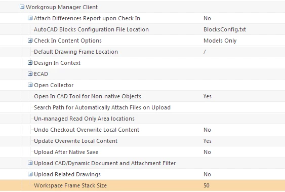

How do we control Frames size in the event manager in Windchill 10.1 using Creo 2 m70 on the client side?
7 replies
August 21, 2014
It's a Windchill user preference setting.
[cid:image001.png@01CFBD55.6E86EDC0]
[cid:image002.png@01CFBD55.6E86EDC0]
August 21, 2014
I set that, but the users have to do anything on their end or do we have to reset Windchill in order for it to take effect . As on the client side they are generating more frames than what is set.
Thanks in advance.
August 21, 2014
As far as I know it takes effect immediately.

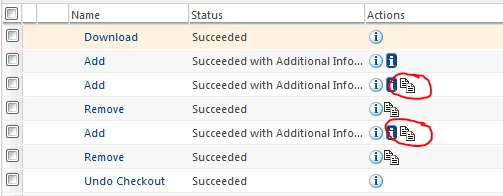

The frames are only the events with the little paper icon. Are you sure you're getting more frames than the target value?
[cid:image001.png@01CFBD56.DD254C80]
Tom U.
August 21, 2014
I just did a quick test. You have to restart Creo to have the setting take effect.
Tom U.
August 21, 2014
Ok, I will have our engineer's test it out in the AM tomorrow and post back my findings, thanks for the quick response.
