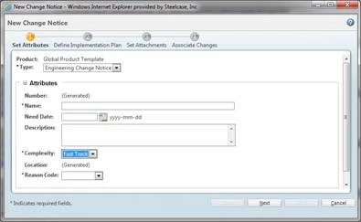

Hi All,

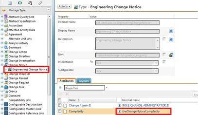

I have soft typed the CN to an ECN. In the workflow I removed the Full Track branch and therefore do not need the "theComplexity" attribute on my ECN. However this attribute is required by Windchill to create my ECN. So I went down the road of setting the Visibility to "Hidden" or "Read Only" both of which didn't give me the desired results. I then went the OIR route and found that "theComplexity" is not defined in the LogicalAttributes.xml file for ChangeOrder2 which means I can't add it as a visible attribute to an OIR in the RuleConfigurableTypeAttribute.properties file.
So how do I hide/remove "theComplexity" attribute on a CN from the user's perspective but still have it populated for Windchill?
