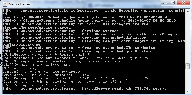

The method server starts very slow.
What may be the possible cause?
Is it only due to memory capacity in my system or else it also because of Processor in the system.
The system has 2GB of ram and core 2 Duo processor.
Windows 7 platform 32 bit
Windchill 9.1
February 8, 2013
This is normal, because you do not have enough ram.
Ideal x64 bit and 8G Ram or more
