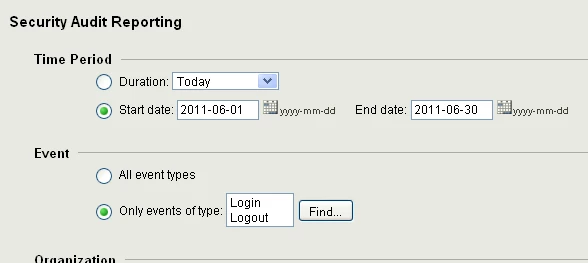

As WCADMIN, you can run a Security audit report, and select login/logout as the events. This will give you concurrent user information:

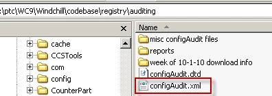

You can also edit your <windchill>\codebose\registry\auditing\configAudit.xml file to turn on/off some OOTB auditing rules.

From Site, Utilities, Security Audit Reporting, this info is available to query and report on- but only if you have not purged the records using the Audit Log Purge Manager function (purging removes (and optionally stores in a zip file) all records for a time period).

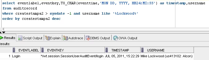

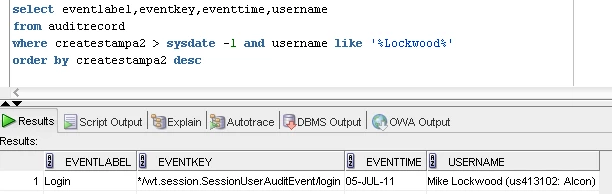

It's also possible to query the database directly - which allows this to be scripted and automated. One sample:
[cid:image002.png@01CC3AEE.3D58F7D0]
If it's desired to see exactly when a user logged on, one can manipulate the date output to include Hours, Minutes, Seconds.
